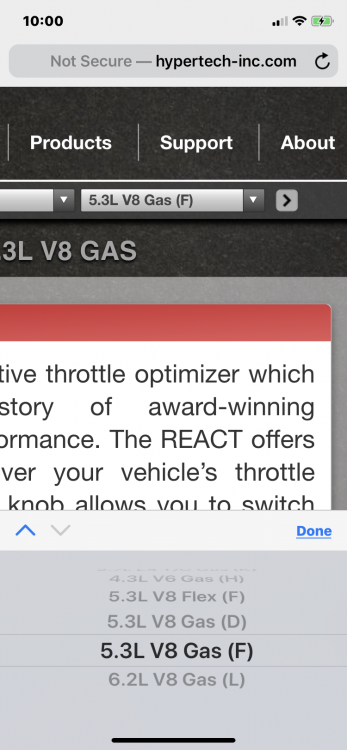

For those who have the hypertech in line speedometer calibration  how do you like it?  Where did you order it from?
Im on hupertechs website and they have it priced at $230?
Also so when you put your info in. It has a option. 5.3 V8 Gas (D) or 5.3 V8 Gas (F).  How do I know which one I am lol?
If if I go with the (F) it doesn’t show a calibration available, but if I choose (D) it has one available.
Sorry if if this is confusing
