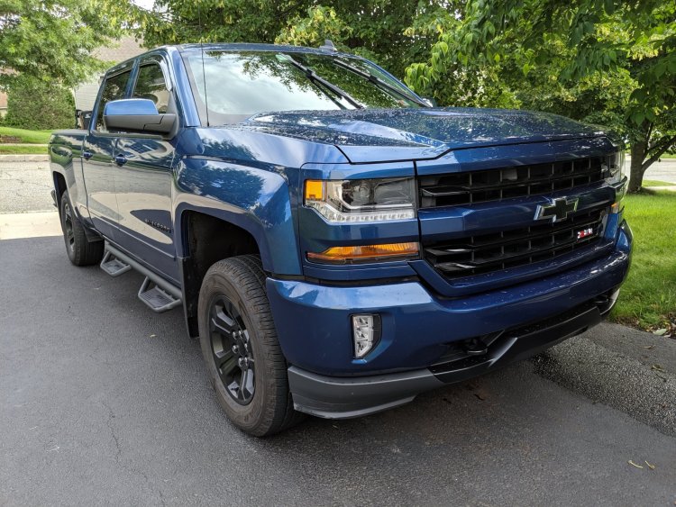

I did mine in bed liner spray. Looks much better to me!008D2C6E-8604-465C-8382-05AE89258DFD.thumb.jpeg.9992e1d7b0ceab7511e34dea6bb2c29c.jpeg
I assume you took it off, so how hard is that?
Not hard at all. Get your plate and mount off and then a couple safety tabs on the back to pull out and the rest is all little tabs that it pops out of around it.
I noticed my bedliner spray is bubbled in a couple spots, so I’ll be taking it off again soon to fix that :-(

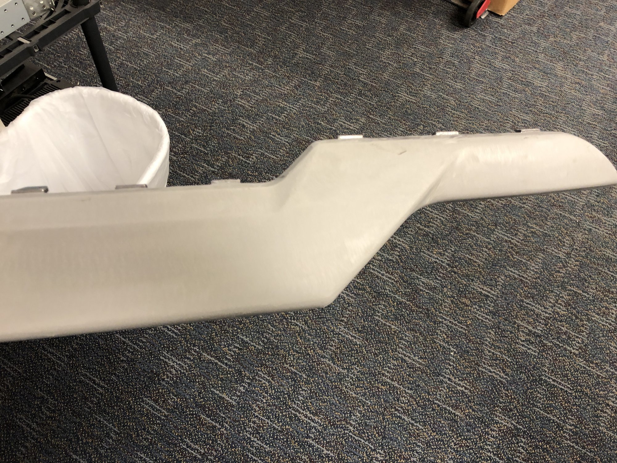

Yes - I just had it wrapped yesterday. Also had my chrome lettering done, bowties and wheels blacked out.
Took me a couple hours, but I chipped off all the spray can bed liner spray and then went to scuff the chrome real good, to find it could be peeled off. It’s literally a thin film of metal.
I never thought what what the chrome would be, but if you work an edge it will peel up like a sardine can. Crappy part is it’s a bunch of little slivers, so takes time.
Now I'm down to just plastic. Scuffed it all up with my air grinder and ready to be wiped down and coated with a better bed liner spray kit.
