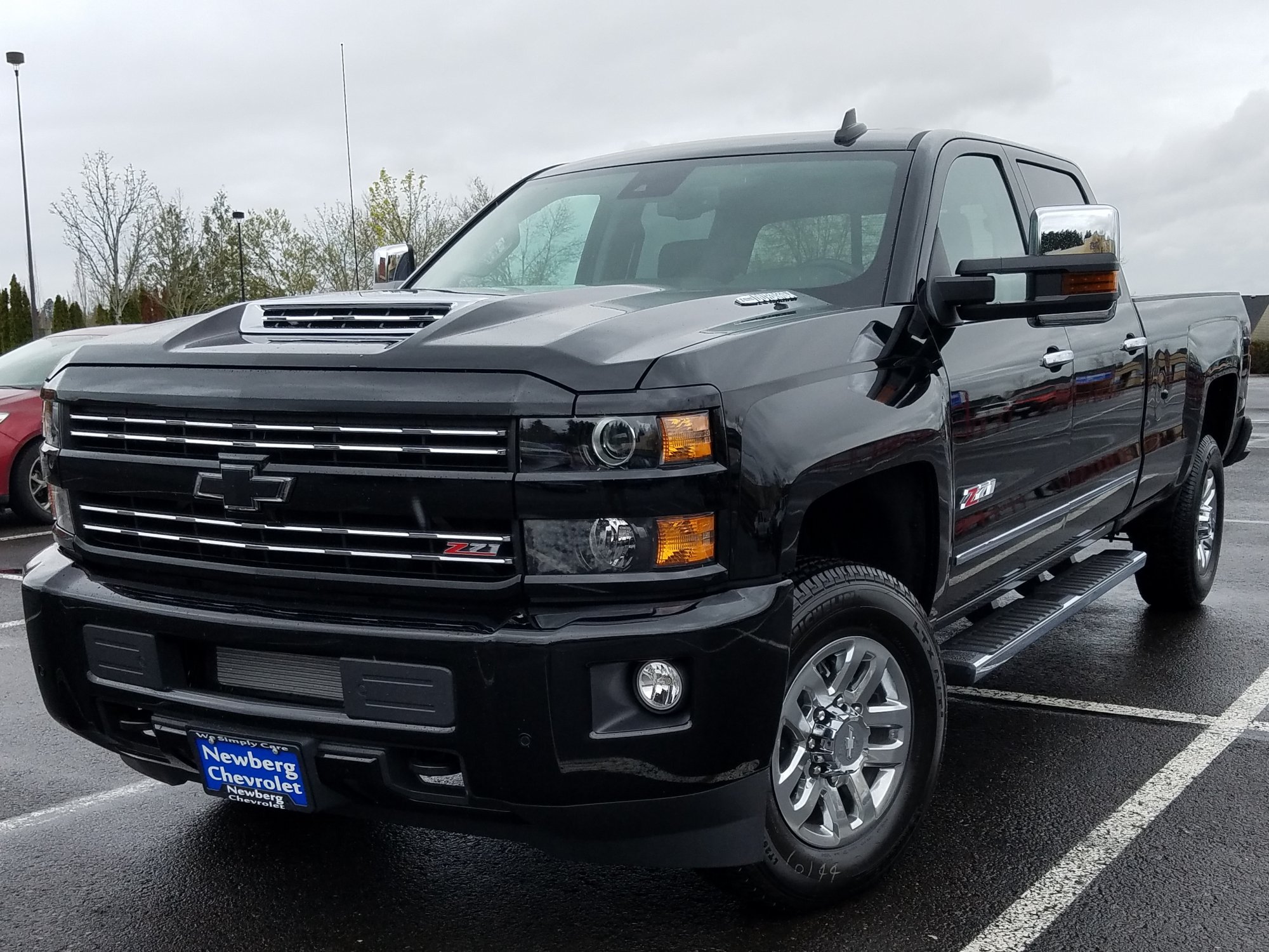

Who's Chapped? Me, that's who.
Took three weeks, but finally got the replacement pickup.  Bowtie glows on this one.  Other than that, and the repaired, previously undisclosed, damage, it's a twin.
Sucks that you had to deal with that crap... Really nice looking truck!
