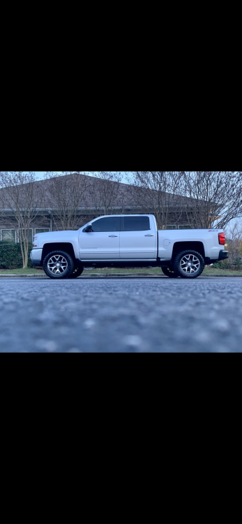

Bilstein 5100 with leveling kit.

I’ve got bilstein 5100 front/rear
- front is set at the 1.25” setting (3rd setting if I remember correctly), with 1.25” top spacer, totaling 2.5”
- 1 inch larger block in rear (2.5” replaced the factory 1.5”).
- still have about .75” of rake in rear
- 33x12.50r20 toyo MT on factory snowflakes.
I rubbed on the UCA pretty bad due to the 12.50 tires, so I added 1.75” bora Wheel spacers, and now I rub slightly on fender liner in reverse.
That said, I feel pretty confident that with 1.25” wheel spacers instead of 1.75”, I probably wouldn’t rub anywhere.
I've got about $500 or so in the suspension, and it rides MUCH better than stock.
hope this helps with decision making for anyone debating.
