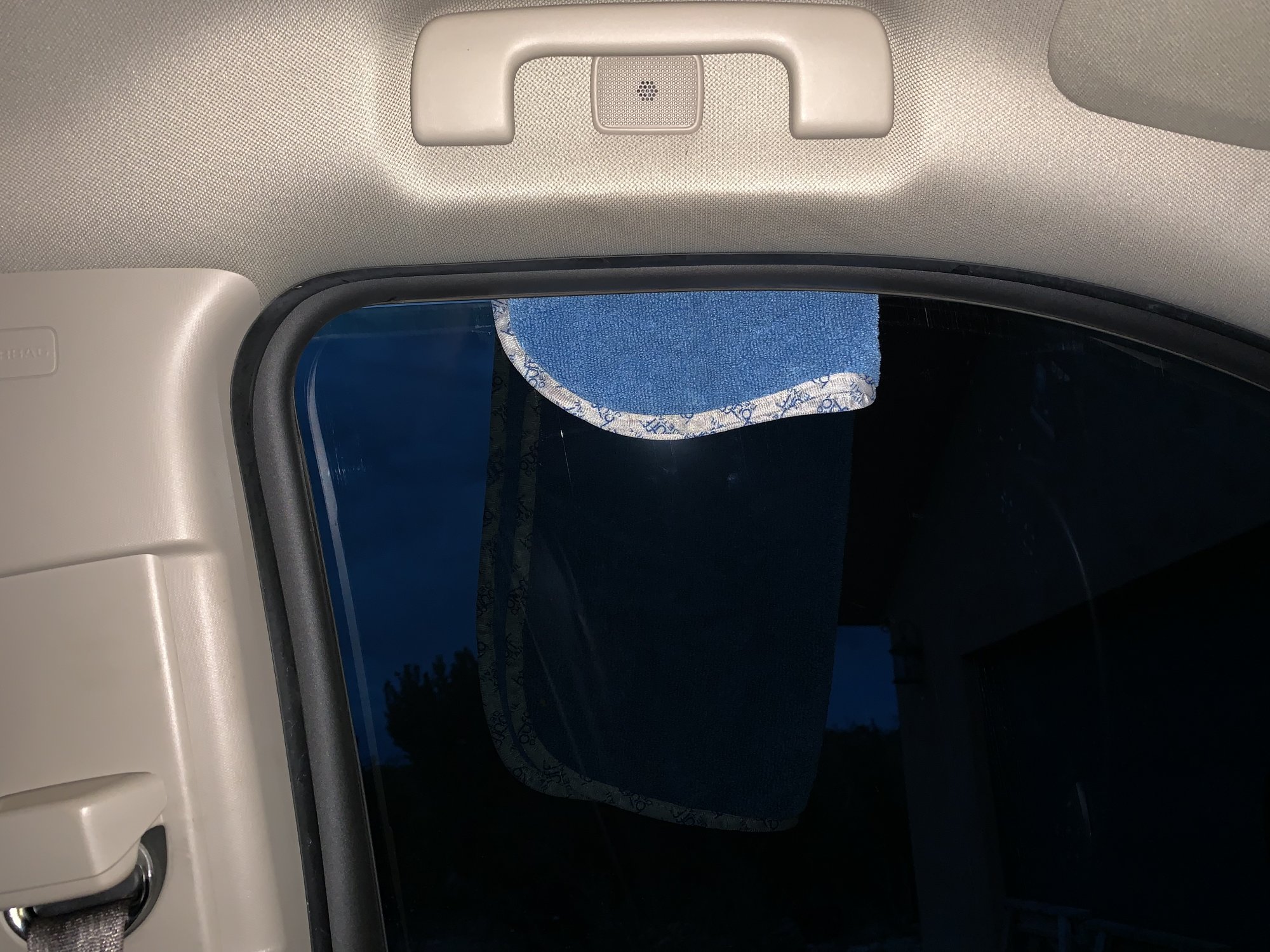

Can you place a shop towel up into the channel and close the glass onto it, to stop it and/or help localize the sound?

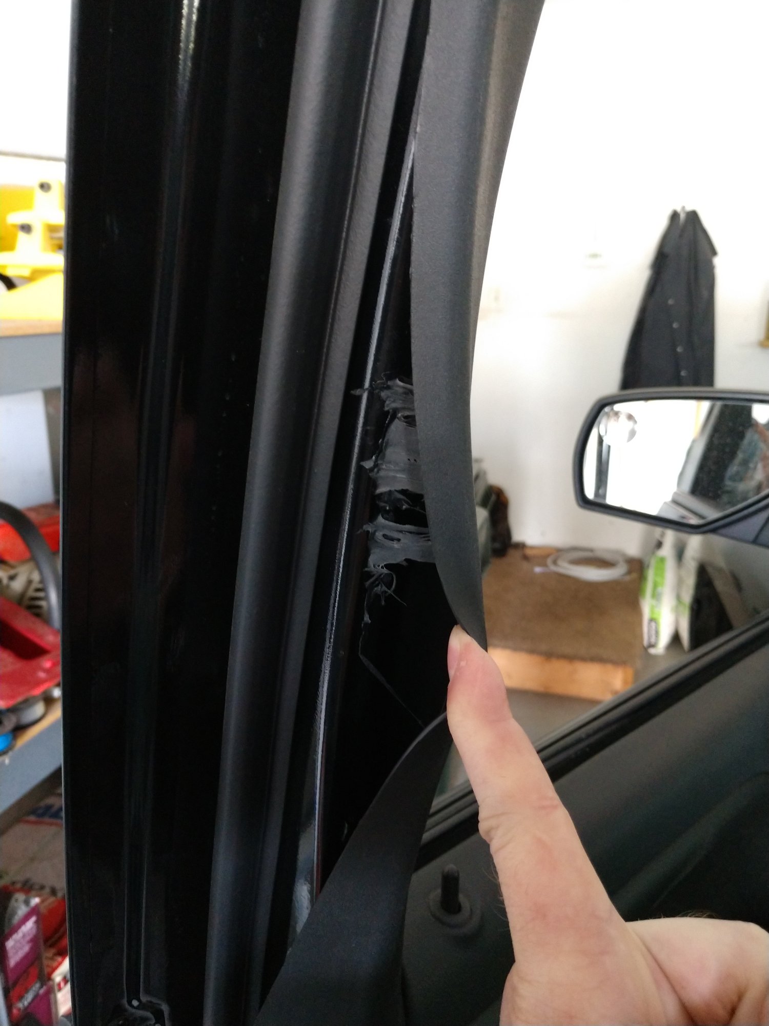

I had this issue on my '17.  On the door there is plastic trim that goes up around the window.  In previous generations this would have been left body color metal.  There is a gasket on the cab that seals against this plastic trim piece.  Since it is not held in well, it rattles against the metal of the door.  I pealed my back and put some rope gasket behind it to fix the rattle.
I'll try the shop towel, andyhaug could you please please show me what you did with a pic? I'd really appreciate it. Thank ya'll so much, I'm not super OCD it's just that this is right by my ear so there's no way I can ignore it or drown it out. Thank ya'll !
 This is the trim around the window on the door.  Around the outside it is not really held in, the window weather stripping is what really holds it.  I just peeled it back enough to put some rope caulking in there and it cannot rate against the door anymore.

Lol tried the shop towel in various places, no luck. Gotta be in the door. Oh well :-/
EDIT: Tried a thicker towel today and let the window shove it into the top corner, that's the spot, it was quiet. I don't know a long term solution but at least I know the location.
