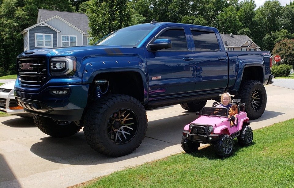

Im scheduled to have my gears installed in 2 weeks by East Coast Gear Supply, and I have decided to go with 4.56 gears. I have a 2016 GMC 4x4 with a 10" lift and running 38" tires. I currently have 3.42 gears and it does "OK" as long as I keep it in tow haul mode.
I was hoping someone who has the 8 speed transmission and 4.56 gears could chime in and give me some feed back. I also considered 4.10 gears, but I think 4.56 is the way to go for my set up.
