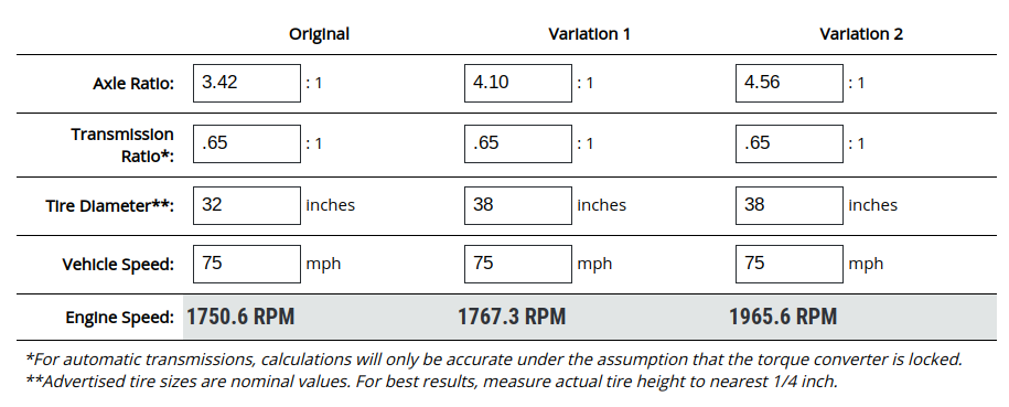

I'm no gear expert but found a calculator to compare ratios and tire size: http://www.dieselhub.com/tech/ratio-tool.html
"Original" is based on a factory 32" with a 3.42 axle and the 8L90's 8th gear ratio of 0.65:1. Variation 1 is with a 38" tire and a 4:10 axle. Variation 2 is the same but with a 4.56 axle. All are at 75 MPH. Looks to me that 4.56 is the way to go.

You guys are a big help. Im definitely going 4.56 and will report back when its done. Im scheduled with East Coast Gear on the 24th for the install.
