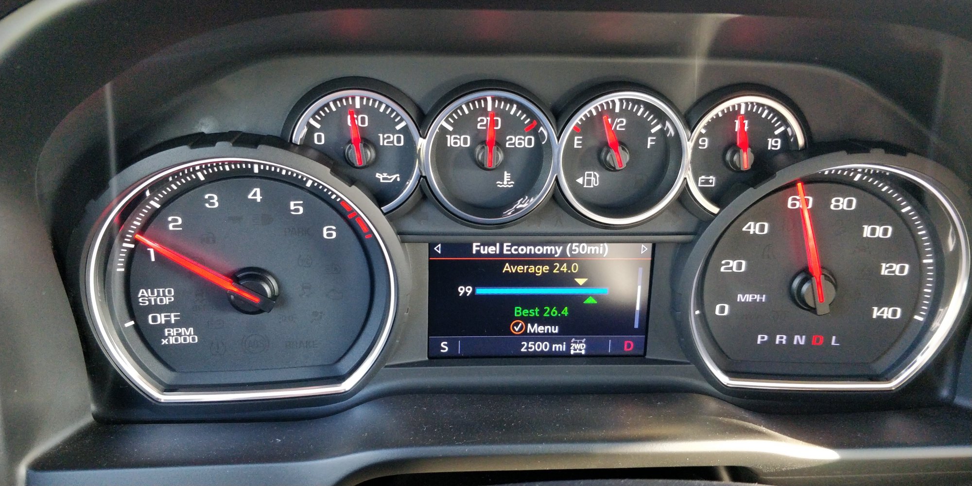

Got back. Really impressed with the fuel economy. 17mpg over all trip lots of 80-85 mph in mt. Screen went black on me had to stop and remove fuese 58 and 41 simple restart didn't cut it this time. Put the missing screws in my mud flaps and the noise is gone
Wondering how would it do towing a travel trailer for long trip. Thinking of getting a 5k lbs bumper pull

Made it to our destination and got some nice picture
Dang GM really made the gauges look bad in these T1s
The gauges are personal preference, who cares, look at that MPG!  It's a truck...
35-40k for a new truck and you get cheap looking trinkets like that. Obviously I cared since I said they looked bad. Guess I should have said IMO that way nobody got offended.
