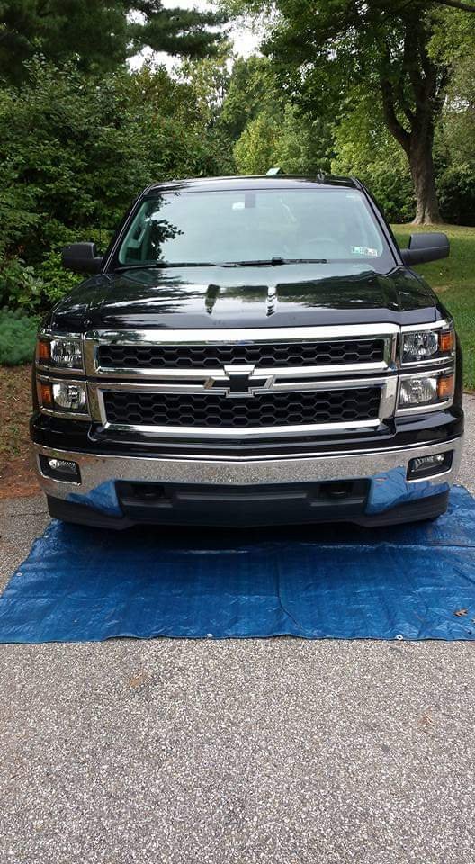

I replaced my 015 all chrome grille to the chrome surround with black honeycomb when I bought mine. Ask the parts guru at the stealership if I could just order the honeycombs since they are replaceable on the 014/015s. Answer was NO as nobody sells the combs separately. He did hit up their paint department about R&R & painting them. They wanted 400 bucks and wouldn’t guarantee  the paint to stick. So it was actually cheaper for me to replace mine after selling the stock one.
I’d check with your local auto body shops/salvage yards to see if they have any “broken grilles” you can rob the combs/Z71 inserts out of. There is several videos on YouTube on how to R&R them.
I did see a set of used black combs listed once on FleaBay & several sets of chrome.
Look for a used/broken one on your local Craigslist. This is where I sold mine to a body guy rebuilding a 015.

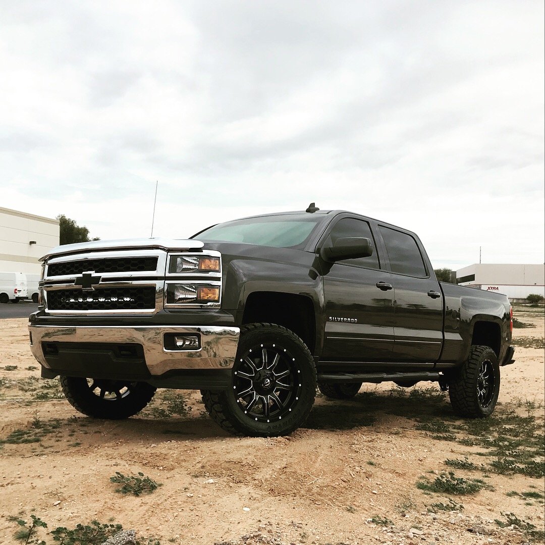

I also did this exact thing for my friend when he picked up his Silverado. I got him a RC light bar and decided to do it while we were in there.
Both trucks spend a lot of time in the desert.

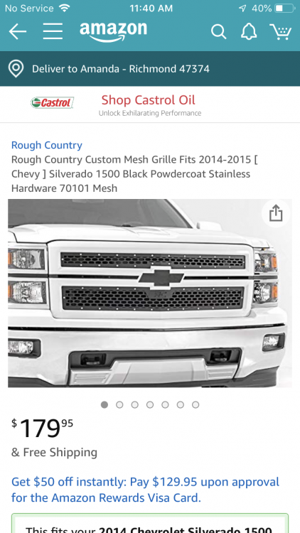

Definitely just find some used inserts online if you can or get a different style from the aftermarket. One thing to note though is the standard black honeycomb grills do not detatch from the grille. I was trying to put chrome inserts on mine and it was all one piece, so finding stock black honeycomb inserts is probably impossible (so dont spend time trying to find that!)
