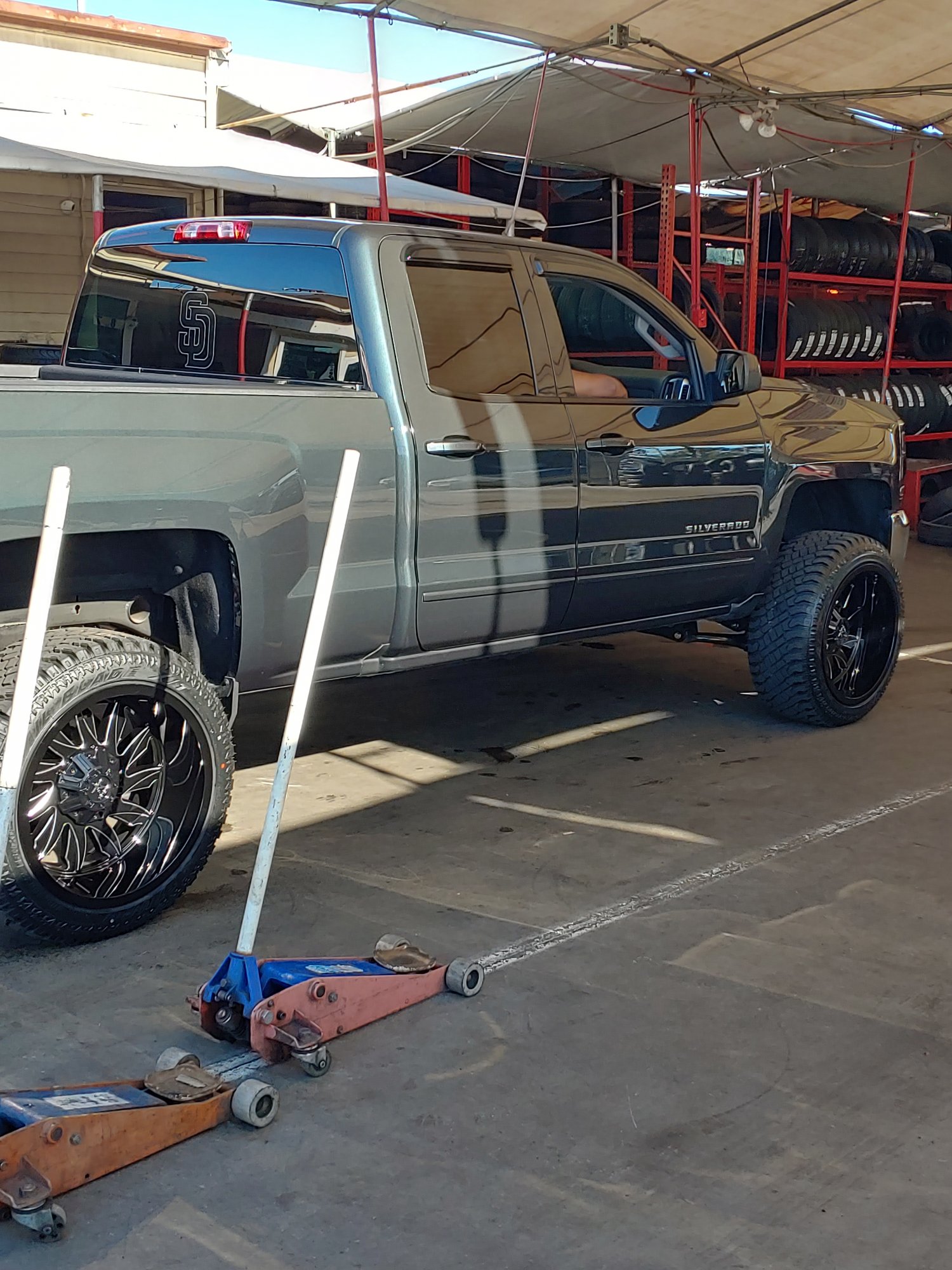

I have a 2018 chevy silverado 1500 with a rc 5 " lift front to back truck sits lower in the front (not level) my question is this if I added a 2" front lower shock spacer instead of going with a smaller block on rear would it create a problem to my front suspension ??   Feed back or opinions would be greatly appreciated ty
I agree, it would cause issues. I have heard the 5” RC lift already maxes out the suspension angles. But I also think that’s in regards to their 5” knuckle lift. They also have a full drop kit like CST. Which one do you have? Also post a pic of your current UCA angles.
The truck looks good as it sits.
Leveling is fine I guess if you never put more than 200 lb in the bed of your truck, but I like my truck to sit level at max payload, not empty.
Thank you guys. No I never do carry anything in my bed. I kind of want get a higher lift a couple of inches  on front trying  find away to go that route with out spending a lot of money and hurting my suspension
