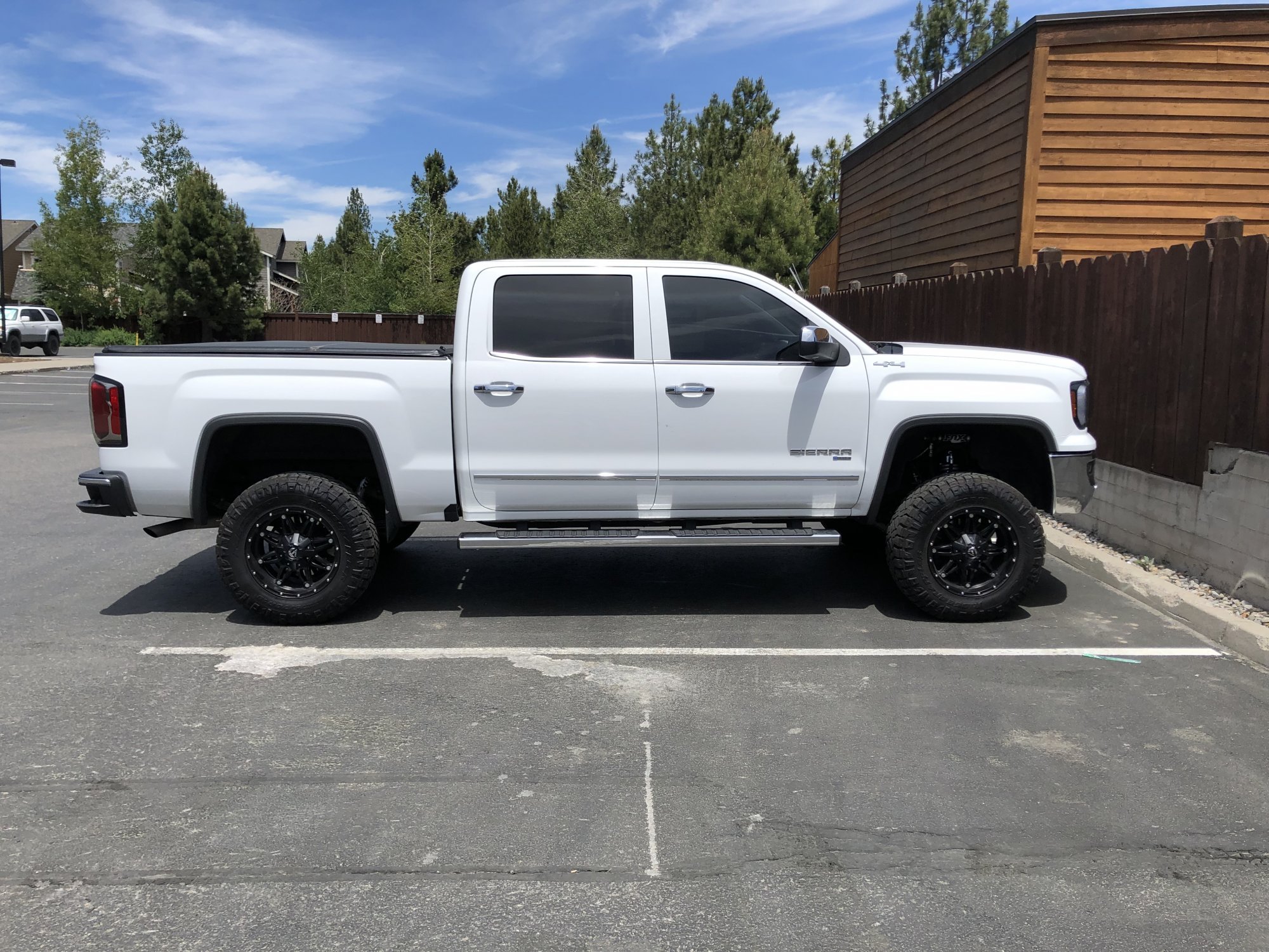

Anyone here have the BDS 4 inch coilover kit? I just got mine installed and it looks bigger then 4 inches! I went with a 4 inch because I have 33 inch tires (275/70/18) but it still looks huge. Are the 4 inch coileovers suppose to show that many threads? Do the springs settle at all? If not i need to drop it about an inch.
Agree, that looks like more than 4". And springs will settle some after a few weeks of driving, but not that much at most maybe 3/4 of an inch.
Looks like a 6+ . You can tell by how the wheel lugs line up with the bottom of the truck.

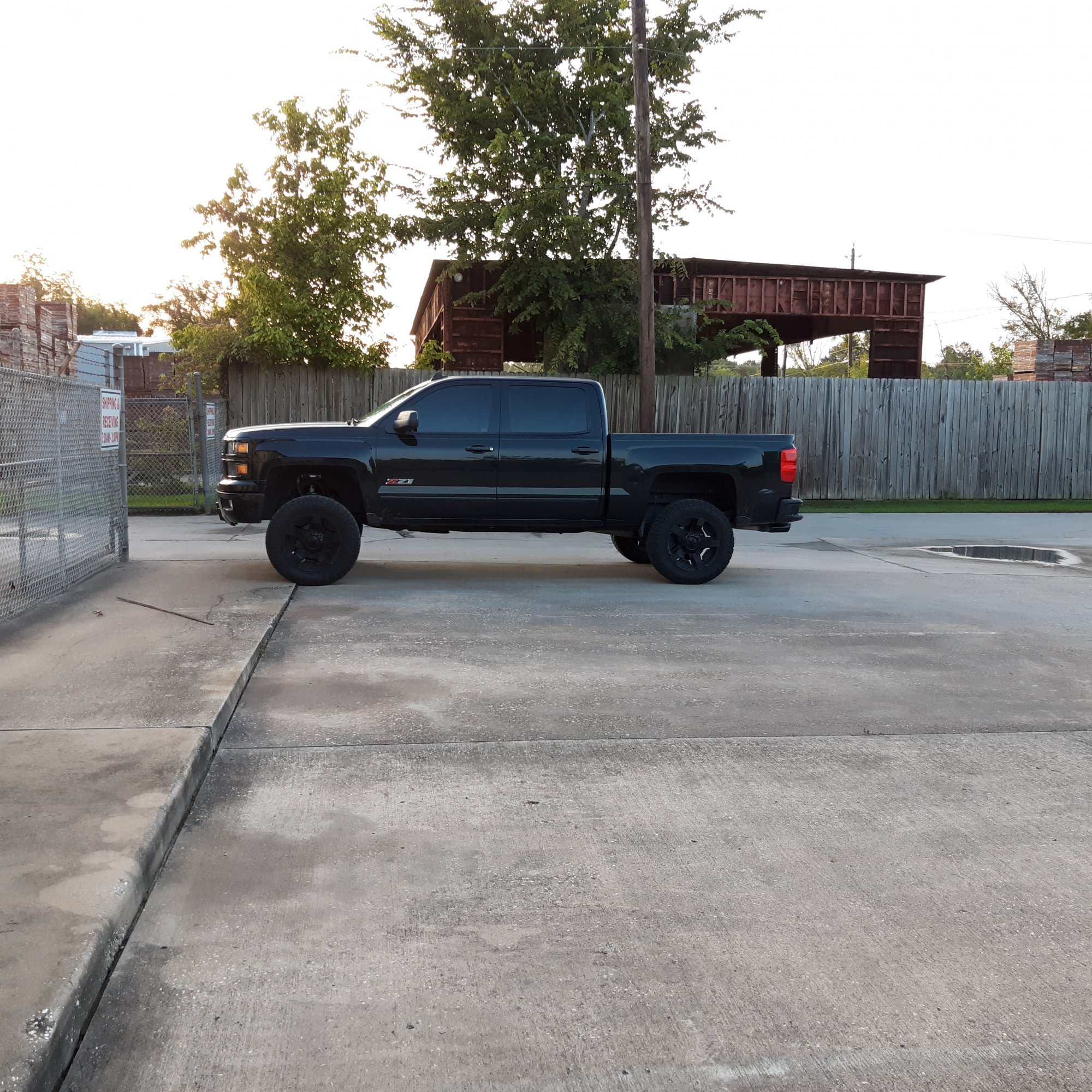

My center hub to bottom of fender measures 27.5 inches in the front. Can someone who has a 4 inch lift or 6 inch lift let me know what theirs is?
Now im worried they installed a 6 inch lift on accident lol.

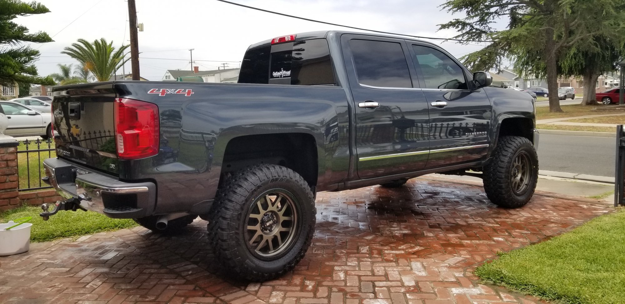

Yours looks right. mine is a 4.5 zone with the bds 4-6  2.5 coilovers.  Slightly adjusted up. Center hub to fender measures 29 .
That looks awesome! Did you have to trim or any rubbing with 35’s? Im considering doing a 285/70/18 which is almost a 34inch
I did have to trim a bit... only rubs while on reverse at full lock
