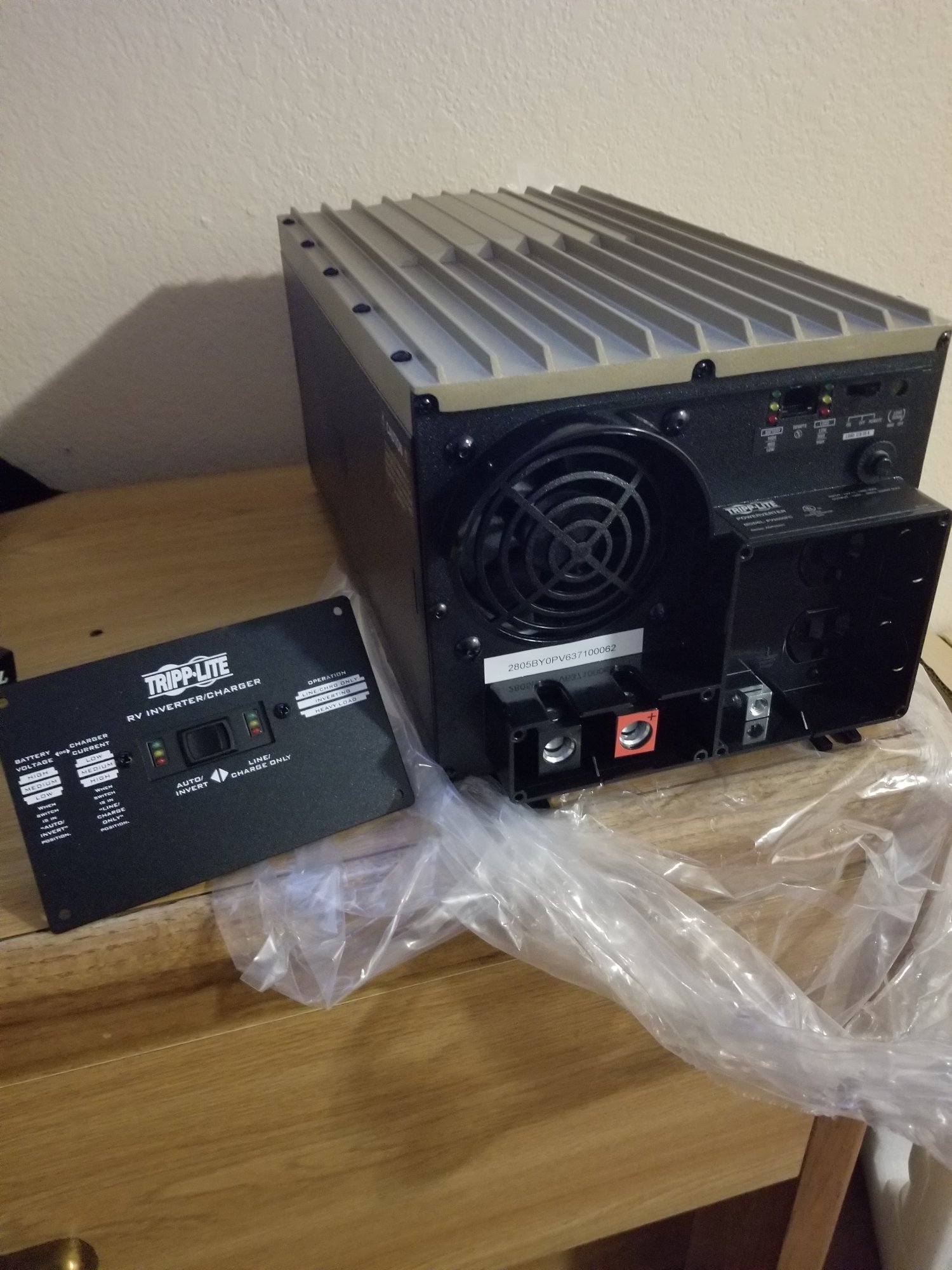

So earlier tonight I got a great deal from one of my customer - a Tripp Lite 2000w inverter and remote control module. Part # PV2000FC for the inverter. He has them on every one of his work trucks and swears by them.
This thing is huge. I've seen on YouTube where an individual placed his under the rear bench - but this thing, impossible. Do i need one this large? If anything I would use it for my laser printer, Milwaukee battery charger, etc - anything work related. Again prolly not, but I really got this inverter for a steal - and it's brand new (well hasn't been used yet). I would like to use it if possible, if anything be really creative where to safely mount it. If not, sell it.

2000W @ 110V = 18A
110V x 18A = 170A minimum @ 12V, and from TripLite's website, it takes 200A to put out that 2000W.
You'll want either a single, higher-output or dual alternators to keep up with that inverter, otherwise it'll quickly kill even a dual battery setup.  And you'll need a high-idle setup, so that the alternators actually put out that current.
If you've got a regular use for it, go for installing it, but it sounds more like it's just something you got cheap and would maybe use it every once in awhile.
I would recommend selling it, as to install it and make it a usable setup will likely cost you a decent amount of money.  If you do want to use 110V stuff at a worksite, get a portable generator instead.  It's smaller, cheaper, way more efficient, you can put it where you want

If you are mainly using low-power stuff, and higher power stuff only for short periods of time, then I would suggest hooking the inverter up to the second battery, with a battery isolator, so you can still start your truck if you happen to use it a bit more than expected.  And perhaps an ammeter & voltmeter on the input side of the inverter as well.  The ammeter to tell you how big of a hit using any given piece of equipment is causing, and the voltmeter to tell you if you should start up the truck to charge up the battery.
Edit:  But make sure you wire it for the maximum current needed for the inverter.  Otherwise, someone (you, somebody else you work with or sell the truck to) will use it to the maximum, and possibly burn the truck down because the wiring melted.

I can get my dad to install inverter - I just have to convince him.. He said it can be done but he does not like the idea of it sitting so far away from 2nd battery. He would rather have it closer, perhaps the foot space between passenger and driver at most - and from the inverter have a long extension cord to wherever I need it.
