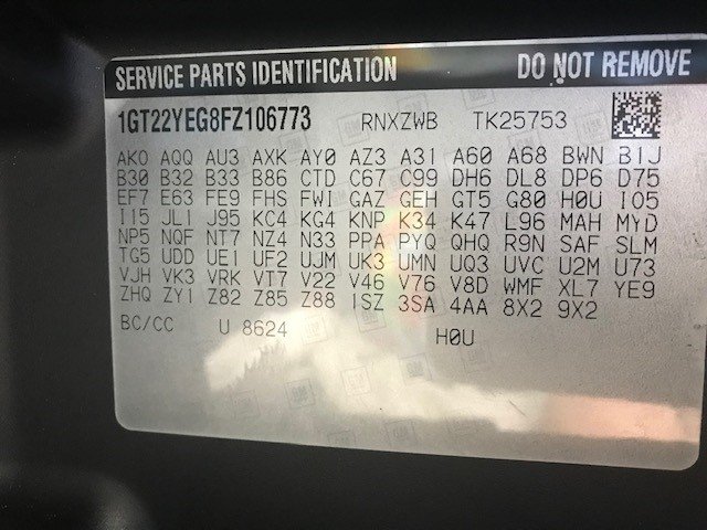

Does your glove box have an RPO sticker? If so, snap a pic and post.
GM did produce a 1st Gen “DPN” Mirror (just like these pictured) for some 14 and early 15 model HD trucks. My guess is previous owner installed them needing only the mirror to function and didn’t take the steps to get the turn signal to work. It could be a factory mirror but didn’t come from the factory with them.
Man I really gotta get with you and talk options on tow mirrors.  These little mirrors suck!!
Yep. So the DL8 code is the factory mirror it originally came with. That is the smaller mirror with just power adjust and heat.
So if you want the turn signal to work, you’ll have to either swap the door harnesses, or modify the harnesses that you have now.
