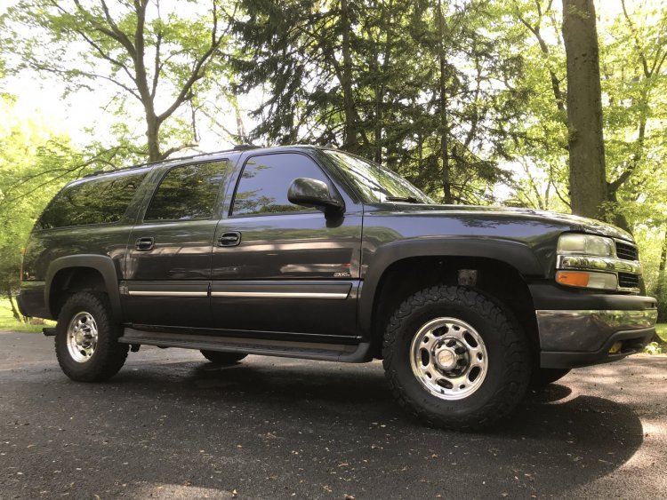

So my "new" 2004 Suburban 2500 4x4 has LT 245/75 R16 tires
When it comes time to replace them, do I swap like-for-like in size, or would it behoove me to change the size?  This is mostly (95% of the time) being used for towing short distances (boat to a ramp).  Rarely any highway, probably never offroad, etc.
Any recommendations for brand/style, etc?
I really like the look of p265 as well in that rim size

Not too concerned with this due to not needing the max towing power.  Plus, the 81.L engine with supercharger gives me a LOT of torque.
265/75s should have come on these new, no clearance issues and no notable SOTP difference in my 6.0 suburban
I have a 02 2500hd Sierra and had install p2857516 I used it to tow a car trailer and do snow plowing no problems fills in nicely the wells and I have plenty of power.
