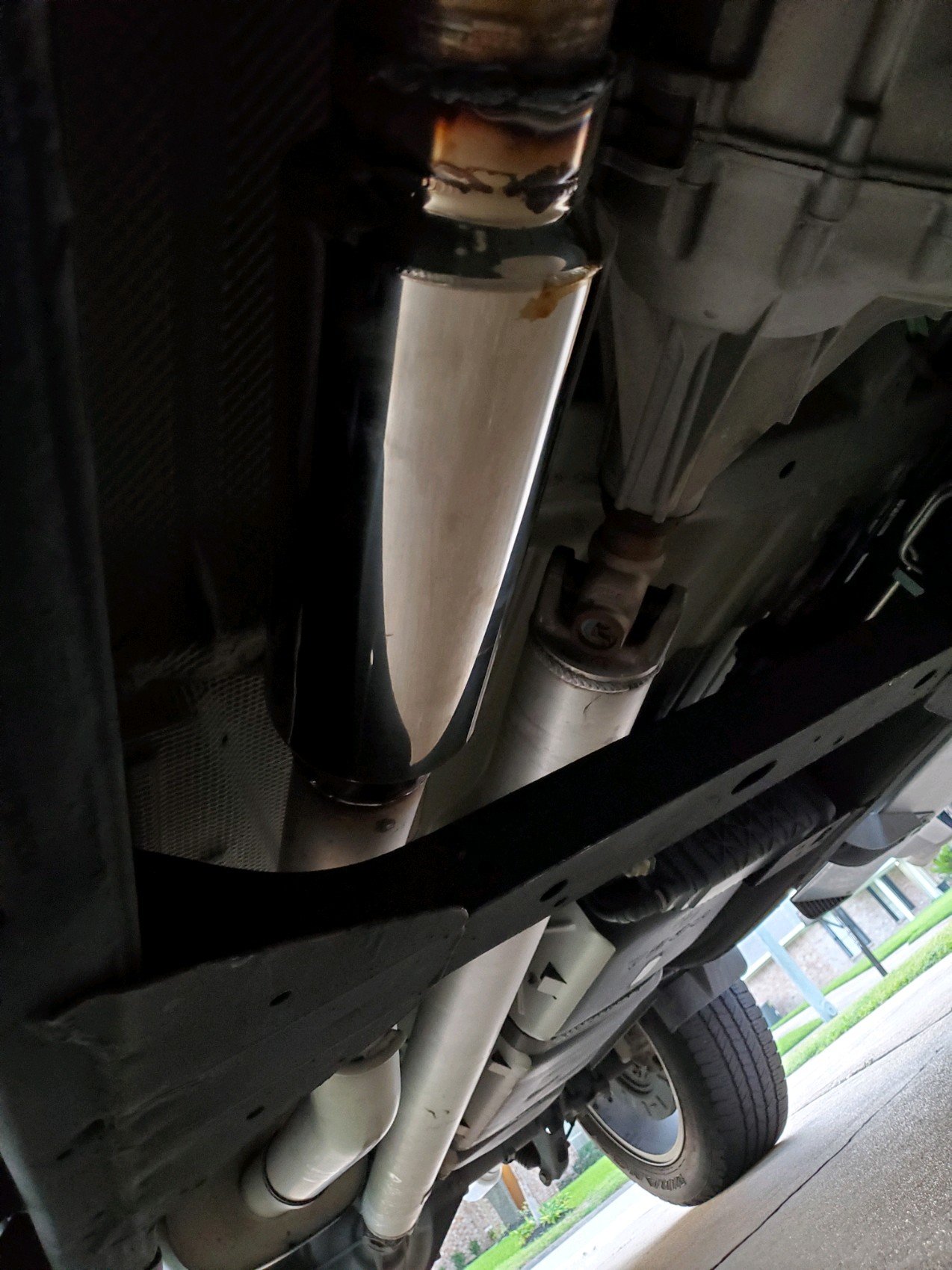

I added a 3.5" vibrant resonator right between the y-pipe and mid pipe today. It really made a difference! This is what I was looking for, close to the Borla ATAK before headers and it is still aggressive and loud when you lay into it. I placed the resonator as far up close to motor as I could to stop the sound early and it definitely make the cab really quiet when cruising and passing half throttle it has a nice rumble and slightly aggressive. When you floor it, it wakes the beast and surprises vehicles around you. Definitely recommend this route for people wanting LT header w/ high flow cats for hp gains while keeping rasp down to a minimum.  39440.thumb.jpeg.3b2612f8c9e4fc558594a1c83a62dc9e.jpeg

I added a 3.5" vibrant resonator right between the y-pipe and mid pipe today. It really made a difference! This is what I was looking for, close to the Borla ATAK before headers and it is still aggressive and loud when you lay into it. I placed the resonator as far up close to motor as I could to stop the sound early and it definitely make the cab really quiet when cruising and passing half throttle it has a nice rumble and slightly aggressive. When you floor it, it wakes the beast and suprises vehicles around you. Definitely recommend this route for people wanting LT header w/ high flow cats for hp gains while keeping rasp down to a minimum.  39440.thumb.jpeg.3b2612f8c9e4fc558594a1c83a62dc9e.jpeg
Is that the 18" resonator?
I might give that a try. I have ARH with a catted Y pipe and a Jones 3535XL muffler dumped right after the axle. It drones a little bit from 1500 to 2000 RPM. I'm hoping this up close to the Y pipe will help with that without quieting it down too much.
