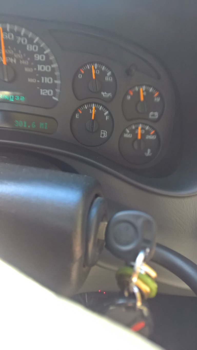

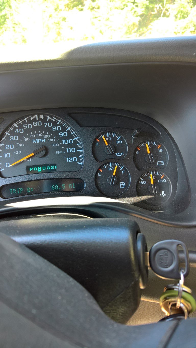

My '05 5.3 Z-71 has normally run about 45-50 psi while cruising down the highway at 55mph, turning about 1800 rpms (4.10 rear end).  Recently, the gauge is showing less than 40 (30-35) and at idle, it's at about 20 or less, which is also a drop from normal history.  I've owned it since new, changed oil religiously, and it's got 100K miles.  Recently had the oil pan gasket replaced, but I know that the oil pickup tube o-ring was not changed as it's not noted on my invoice (didn't know about that before doing some research) :(  Possibly an oil pressure sending unit? Gauge cluster was replaced a few years ago with an updated stepper motor design.
Other than wishing I'd had the shop replace the pickup o-ring when I spent $475 to have the oil pan gasket replaced, any advice?
Thanks!730127383_oilpressure2(Medium).thumb.jpg.55977c698f907bb3d6698d434169cafb.jpg612172658_oilpressure1(Medium).thumb.jpg.d27f58eec21b6af0f7cdf71a9ca55b4e.jpg
Hook up a mechanical gauge and see what the pressure really is. Proceed from there.
The filter screen if there is one for the oil pressure switch could have junk in it too.
Update - - oil change, 5W30 Chevron Supreme and a new Purolator One oil filter....voila, back to normal/previous levels. I'm guessing the viscosity was poor on the old oil and perhaps a filter problem with the PF46E, but whatever the case, I'm happy now.
Do you suppose the shop reused your oil or used an inferior oil?
Bill336, that's a good question - - It's a reputable shop, I'm guessing an inferior oil. I'm 1000 miles into the Chevron Supreme 5W30 and all is still good.

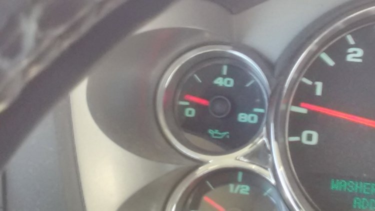

have a2011 later c  can 5.3 starting  pressure  isabou 40  once I warms up rips to 0 hangers oil pressure sensor  2x aftëf market then dealership  paŕf he check engine  light  comes on at Hut down an Inger beggings I poked o dealër th y Corey zaid ascending  unit now säys liftès or brain there  is no miss runs great wanting to harvest $2300 plus parts I can't afford can't get loan has 116k an babiëx oil change with synthetic  e Erykah 3 months or 3000 zàme filër qnd oil usèx sinë Brenda new Suggestions  please
Probably need a new oil pump pickup tube o-ring.  Fill the engine with 8 or 9 quarts of oil and see if the pressure stays up.  If it does, that's your problem.
