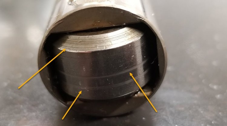

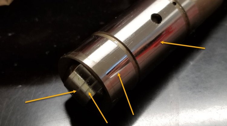

2 years ago I bought a used 2015 Sierra SLE Z71 (crew cab, standard bed) w/ the 5.3L V8 and 6spd automatic transmission. I recently experienced a misfire. I took it to the dealership with 61k miles on it. Initially they told me that it was a bad coil pack, but when that didn’t remedy the misfire, they suspected the injector. The injector was replaced, but the misfire remained. Next, they ran a compression test on cylinder #6. They said it had, “low compression.” Up until this point I would have been out of pocket for whatever the repair cost would have been, but since they determined it was internal and had to open it up, the factory powertrain warranty would kick in. Long story short (and not to bore you with all the details and the poor experience I had with this dealership in question), one of the AFM lifters collapsed, causing a bent pushrod. 2 weeks later (from when I dropped it off) they call me to tell me that it’s ready to be picked up. The bill was just under $5k in parts and labor (nearly 20 hours billed) – luckily, 100% of it was covered under the factory warranty.
So, what’s my issue?
They replaced all the lifters and pushrods. That’s all. And whatever else was required to complete the service (coolant, gaskets, oil, etc). But, component wise, just the lifters and the pushrods. For nearly $5k, I would have thought A LOT more would have been done than just swap the lifters and pushrods.
Anyway.
My concern is with the camshaft.
The lifter that collapsed had some minor scoring on the roller (pictured below - both pictures are of the same lifter, just from different angles). Is this normal wear? I inspected a lifter from a different cylinder for comparison and the roller of that lifter did not appear to have any abnormalities.
Common sense tells me that if there is scoring on the roller, there is probably similar marks on the surface of the cam lobe.
Were they taking a shortcut by not pulling the camshaft? Will this affect longevity? Can I expect premature issues down the road?
Or, am I overthinking this?
Thoughts? Opinions?
Has anyone else had a dreaded AFM lifter collapse and have the repair covered/performed under warranty? If so, what was replaced?
Thanks in advance for your time and input.

Well if you've got lobe issues the engine will not run great due to a valve not properly opening and closing. Does it still have symptoms of a misfire? You can also have noticable lifter tap, a rough idle, rattling sound at higher rpm's, or the engine just feeling doggy. If you have none of that and the engine is running fine and I wouldn't worry about it. I had a lifter collapse about 10-15k miles ago and they didn't replace the camshaft because nothing looked bad. I've had trouble free miles since the repair, engine performs great.

I didn't pull the cam, but I did take pictures of the collapsed lifter that the dealership replaced. I was more so just speculating that if the roller was scored then the cam lobe probably has similar marks as well.
I do agree with you in that there's no real way to know. Maybe an issue arises 2k miles from now, or maybe I get another 200k miles out of it before I experience another problem like this. I guess all I can do is stay on top of maintenance and hope for the best.

On the marked roller and mating surface of the camshaft... I recommend that you install a drain plug with a good magnet. If the hardened surface of the cam starts to fail on that lobe.. some of the remnants will end up on your magnet. Each time you drain, you will be able to see if any of the iron hardened parts are starting to shell.. You can get fancy and weigh it after each change and track it. In my experience, though, you will look at it and know when something is flying apart inside.
That's a good idea.
Thanks for weighing in on this.
I think I'll just have to keep a close eye on things for awhile.

My cam and lifters where scored just like yours.  So I did a cam swap and DOD delete so I don't have to worry about it happening again.  And if I did all this work myself I don't have time to do it twice.
But before I did the swap I knew I had a problem because I could log with my HPtuner.  I saw that as soon as I got into the throttle semi hard and the RPMs got up to 2,000 or so.  It would peg out the Knock sensor with 12 or 13 degrees of timing being pulled and I had no power.  Before I ever had this problem, I had 0 knock or very very little.
Also I you wanted to go through my cam swap thread on performancetrucks.net you can go to page 7 and 8 I think it is and see what my lifters look like and what the cam looks like.  My lifters looked worse than the cam but the cam still had some scoring on certain lobes.
