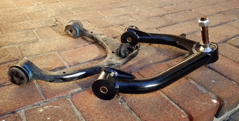

BCMoto Posted September 25, 2019 Author Posted September 25, 2019 Here are a few pics of the OEM damaged part and the new fabtech uni-ball a-arm. Rides nice no complaints. These seem way stronger and make me feel better about going out on trails again. I rather have this closer to home rather when we go to moab in February.
