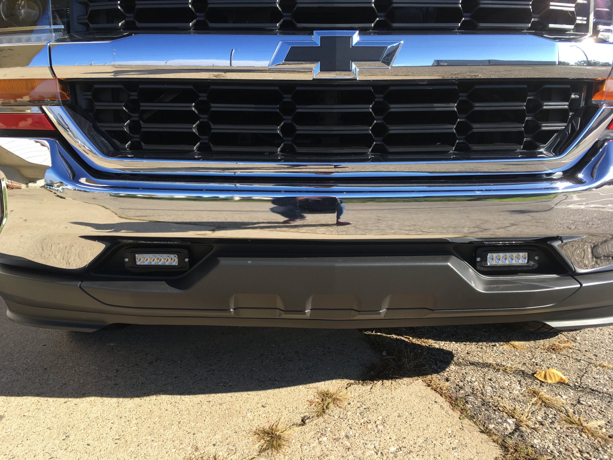

I have the 2017 silverado custom and unfortunately I did not come with the fog light option. My first thought was to get a replacement oem bumper cover with the fog lights. This seems to be more pricey than I'd like.
My question is has anyone tried to mount fog lights or led cube lights where the tow hooks would be? If so what did you go with and how was it done?

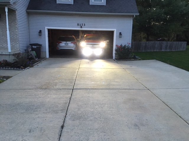

The lights are Rigid SQ-R flush mounts.  I used the mounting blocks from Rigid and still had to shim the bottom to level them.  I just cut a hole in the air dam, used a piece of thin metal on the back of the air dam to add a little stability.  Ran the wire to the overhead.
