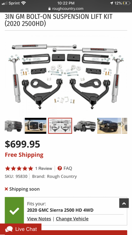

Here is what I found.
Rough Country 3” leveling kit
sku#95830 has upper control arms and shocks
After you can fit 22x10 8x180 with 124 bore
you have to trim the inside of the Front tire’s rear wheel well extension and the edge of the front wheel well near the engine heater plug on the drivers side. Same amount of trimming needed for the passenger side.

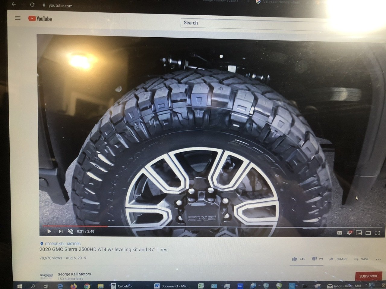

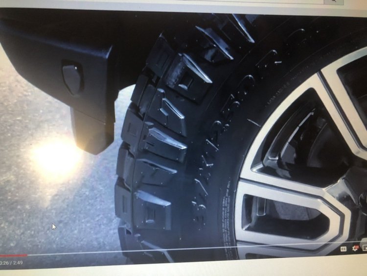

I was told by 4 wheel parts I needed to put a 5” lift and I’m getting to old and fat for all that climbing. Although there is a vid in youtube that has a guy saying he only did a leveling kit and put 37 on. They are 20” but that should not change the overall size of the tire.
Haha.  Can’t wait to see the 35s on 22s.  I have same concerns as u around not enough tire but I don’t want to regret going too small.  I also agree that 22s should change much over the 20s. It is all about offset and wheel width but if I am wrong I hope someone educates me.
I too saw the video above.  Factory wheels and offset with some minor trimming.  Haven’t drove it but have to imagine there is more to it.

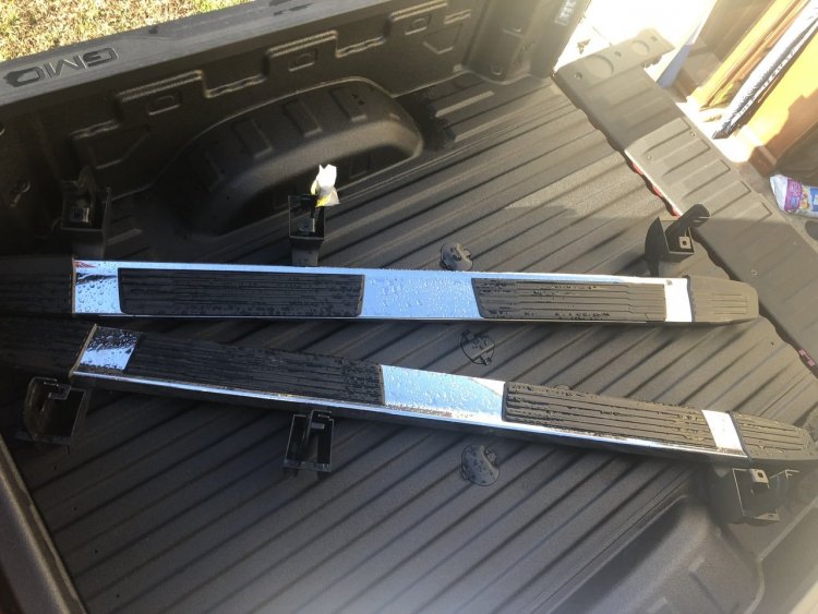

So after going back and forth yes and no I have decided to wait for the full kit to come out. I didn’t buy a Denali to mess up the ride over wheels. I still want to get the Amp auto steps as the stock steps are pointless. I need to research to make sure they drop lower than the stock steps. Does anyone know?

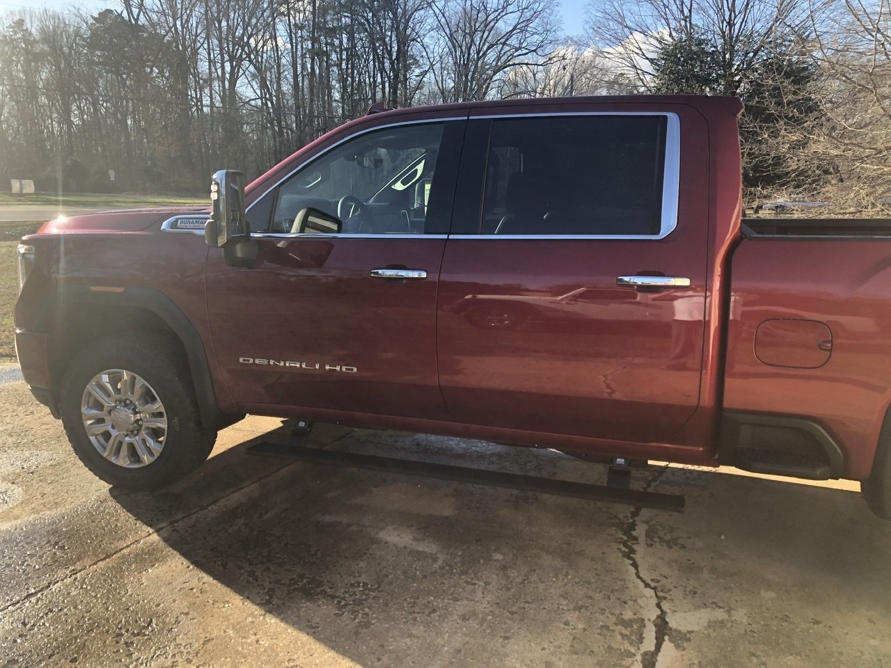

Those power running boards look awesome.
Are they Amp research?
Amp and RBP are the main choices but I believe Amp leads the market. I’m pretty sure I’m getting Amp but still researching.
8 hours ago, BigBru said:
pardon me, i figured it out.
Amp Research Powerstep XL
The Amp XL drops lower but it has a black box hub so the steps do not tuck under the rocker panel. If the truck has a 5” lift or more seems like a great choice but with a leveling or lower lift I’m not sure I want the box hub.
i know this is a level kit Heading but since we commented a little about the power step I figured I would update. I got the regular Amp power steps installed and I love them. They drop lower than stock steps sit and are not as close to the door sill so they are more ergonomic. I have a injury and they help greatly.
