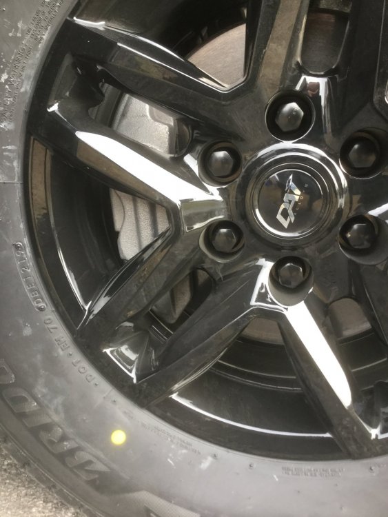

We fitted the DAI Peak wheel on the truck and it barely cleared the front calipers.  Didn’t like it, felt like if a rock kicked up on dirt road and got into the rim it wouldn’t be good.  Basically 2mm to 3mm clearance.  Also the tire diameter from the original was down about 1.5” which I felt looked too small once on.  Luckily my tire guy worked it out with me and credited back the tire package and we ordered something in a 20” wheel.  Here’s a picture with the DAI Peak wheel.
Is that a pic of the 17”?
Crazy how a 17” barely fits nowadays.

Yes that picture is the 17” DAI Peak wheel.  It had no problem clearing the back but the front was too close for my liking.

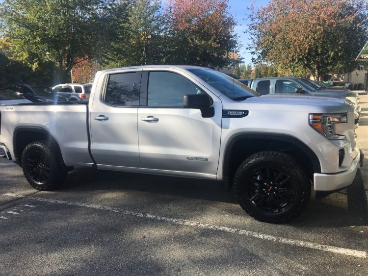

Considering the AT4 has an option for 18" wheel on the GMC website I'd assume that would be fine.  Either a 265/70R18 (32.6" diameter) or 275/70R18 (33.2" diameter) are pretty close to the factory 33" diameter tire that came with the truck off the lot.  The 18" wheel would probably provide about a 1/2" space around the callipers seeing that the 17" just cleared them.  In the end I just decided on getting a 20" wheel for my winters using the Replika R204 wheel.  Got them installed today and they fit nicely.

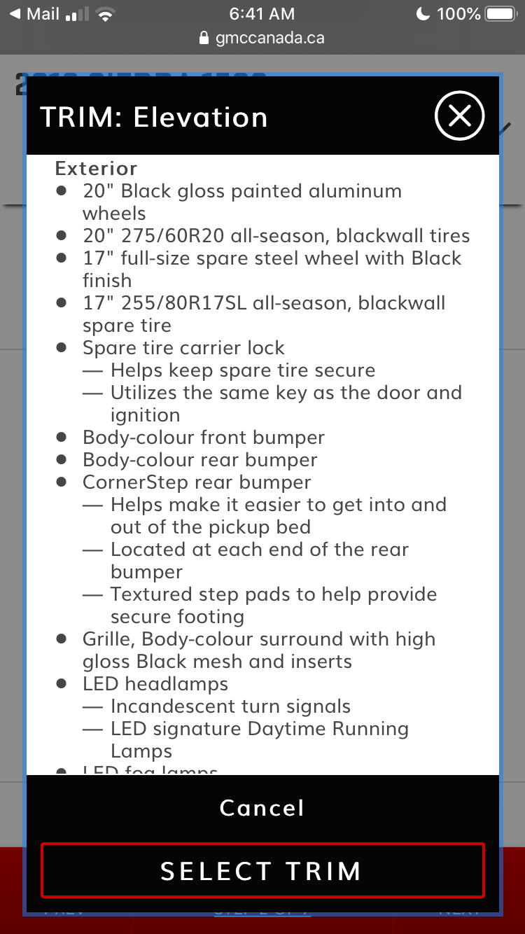

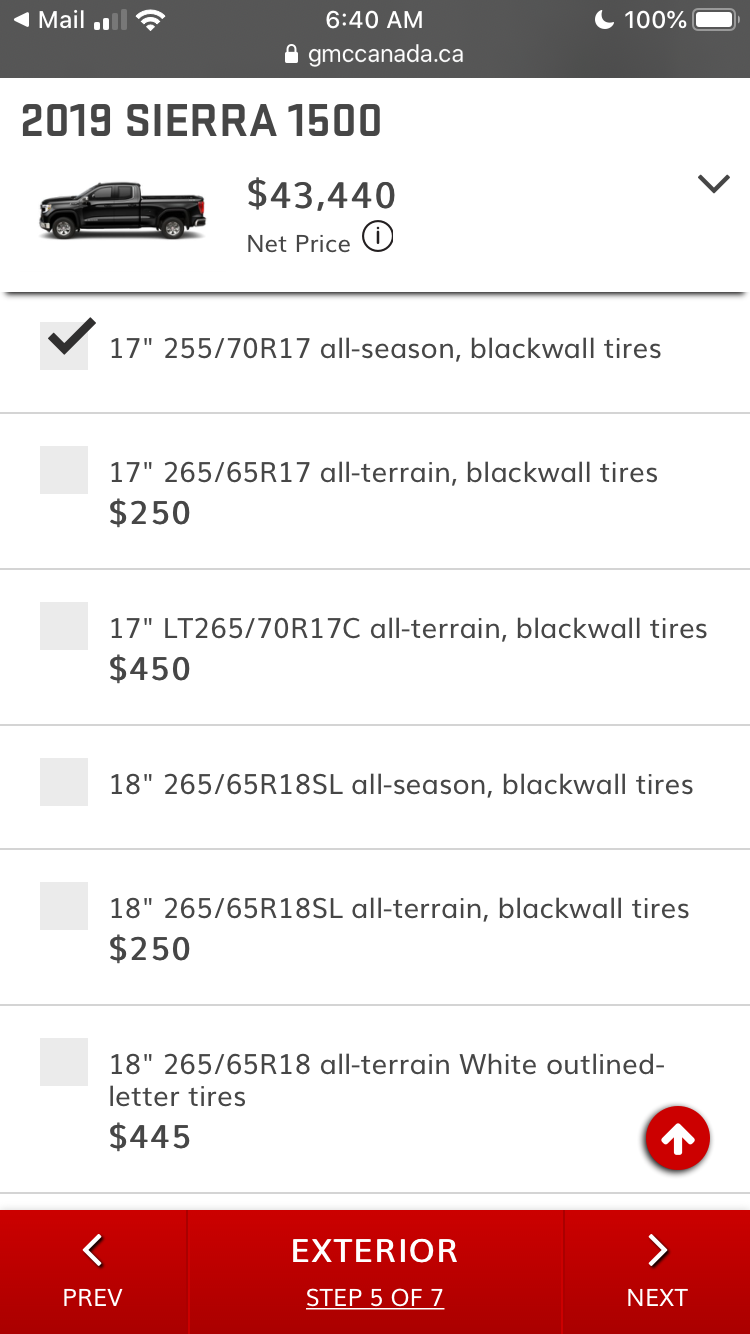

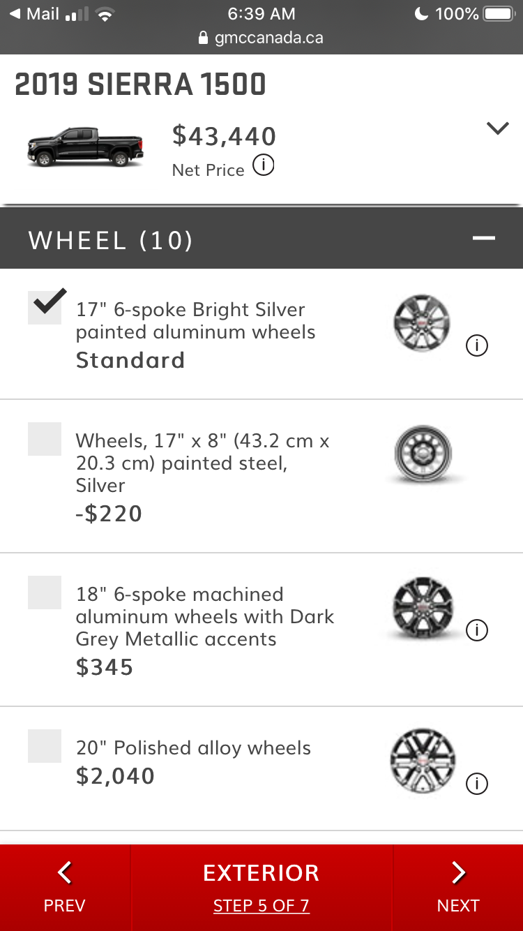

Also looking at the Sierra SLE trim you can get 17” or 18” rims.(First 2 pics are the SLE trim)  The overall tire diameters are smaller on SLE’s compared to my Elevation with 275/60R20’s(33” dia)
My Elevation also has a full size 17” steel wheel spare that has a 255/80R17 tire, also 33 dia.(Bottom pic).
