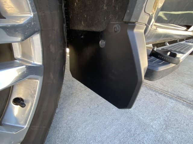

I have a 2019 AT4 that came with what I would consider sort of mud/splash guards on already (see image) on the front and rear. I’d like to get larger ones that provide better coverage for the salt and snow for this upcoming winter and am considering the no drill mud guards from Husky Liners. Has anyone had to remove the little splash guards from the factory yet and is it a terrible job? Anyone have experience with the no drill husky liner mud guards and if they are worth a darn? I appreciate any feedback.

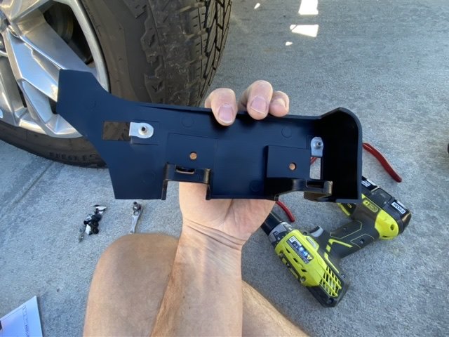

The GM ones From the link below, will arrive tomorrow. I’ll let you know how easy they are to install. Hopefully they help, I already got a chip in my door from the first snowstorm of the year! I ordered both front and back.

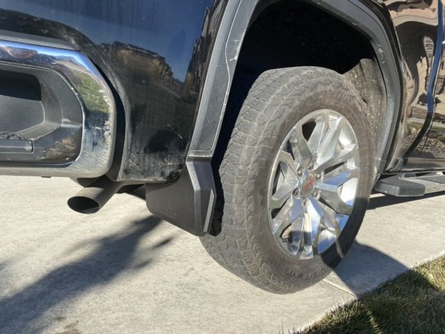

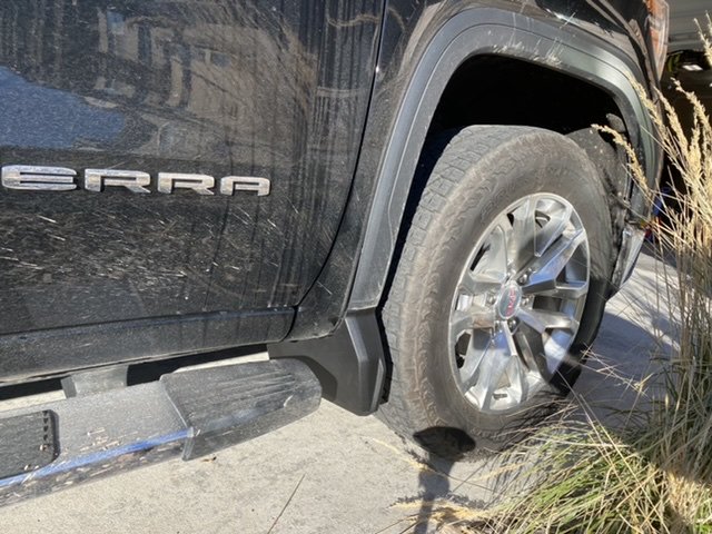

Aight, here you go. Install is easy. Clips can be a bit hard to get on. As i mentioned in the prior post, it installs over the factory mud-guards. The fronts use replacement longer screws (included). The rear re-uses the factory screws which seems odd but the fit seems tight. Definitely much bigger and taller than the factory as you can see in the pics.

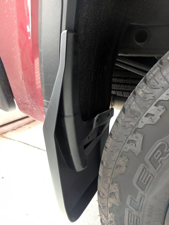

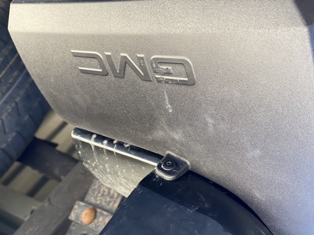

I installed the GMC mud flaps. They are wider and longer. I like the look. I did have to drill in the rear mud flap. Front requires 2 rivets, one which goes in a hole that already exists, the other is in the wheel well liner, which is cloth. The pics below are from the back D628A459-B89C-4C71-867E-FFB8F7861E2B.jpeg.ba5b7e965e6fdacaeb76eb9ddac7dc0f.jpeg
