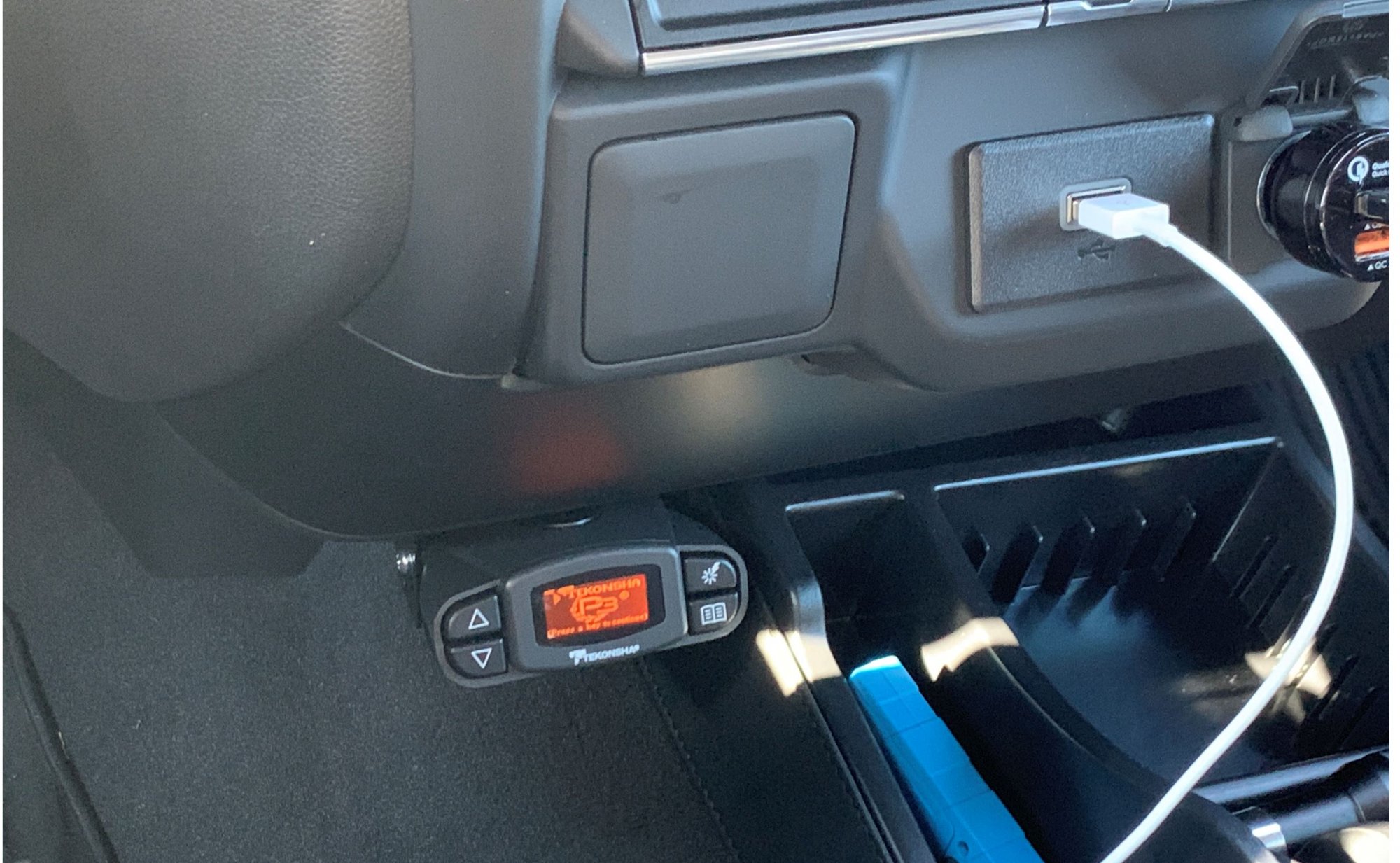

Added an aftermarket "towing package" to my '19 Custom this weekend. All told cost $376.71 and took an hour to install (hitch included--only 4 bolts, but you will need an impact). Everything is literally plug and play.
HITCH: https://www.amazon.com/gp/product/B07Q4R4NM2/ref=ox_sc_saved_title_4?smid=ATVPDKIKX0DER&psc=1
BRAKE CONTROLLER (Can get a less expensive model, but this is the best rated, with most features): https://www.amazon.com/gp/product/B000P17NXQ/ref=ox_sc_saved_title_2?smid=ATVPDKIKX0DER&psc=1
WIRING PLUG: https://www.amazon.com/gp/product/B001NYYREC/ref=ox_sc_saved_title_5?smid=ATVPDKIKX0DER&psc=1
BRAKE CONTROLLER HARNESS: https://www.amazon.com/gp/product/B07LDBYB1G/ref=ox_sc_saved_title_3?smid=ATVPDKIKX0DER&psc=1

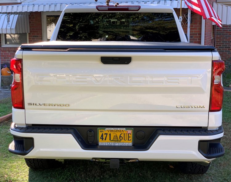

How much room does that hitch leave between itself and the spare? Also, is it really just as
concealed as the factory one is?
It’s  just short of touching the spare at the top. And yes. It’s just as concealed.
