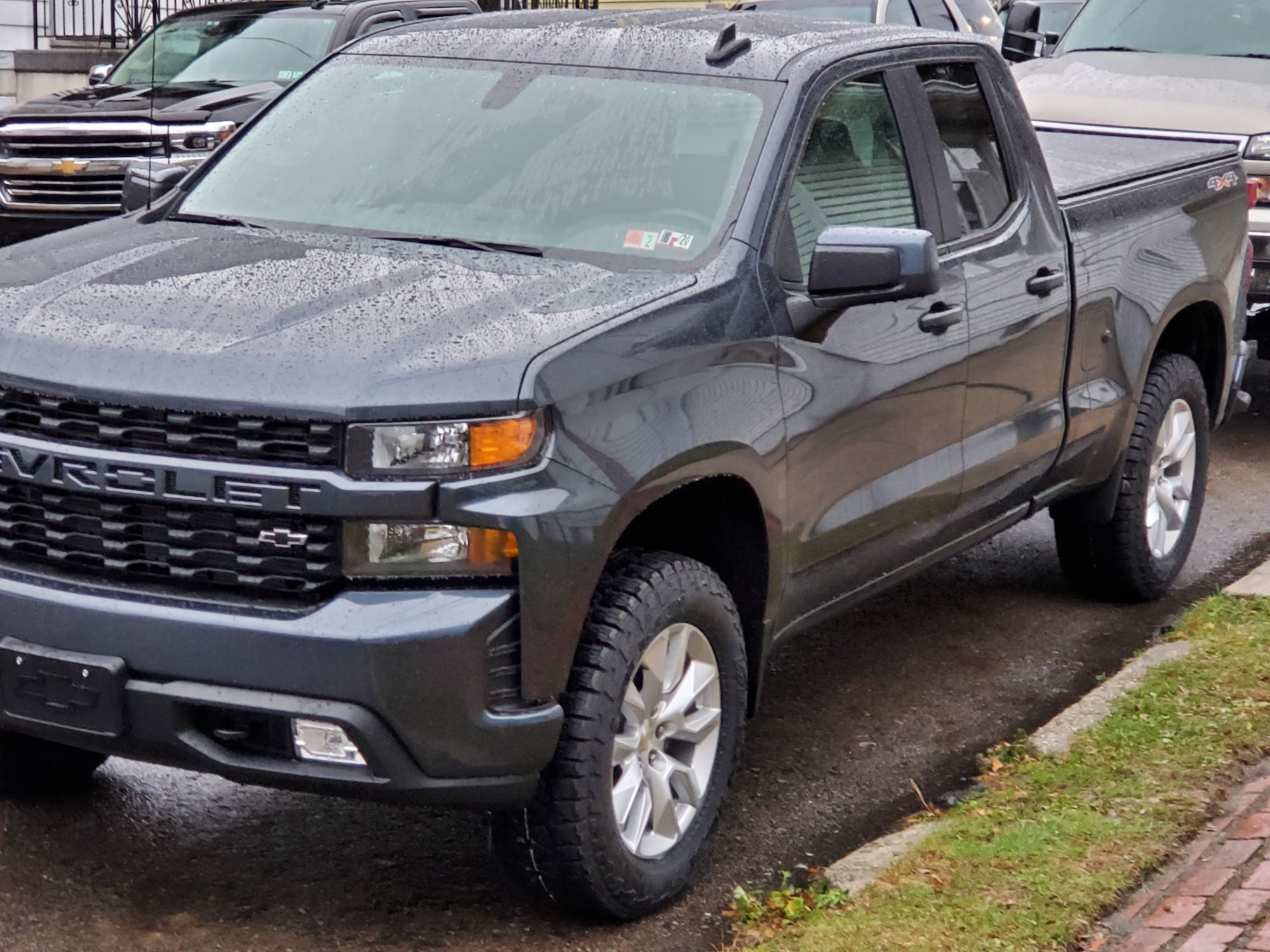

Anyone running 295/60/20 tires with 20x9 +1 offset wheels or stock wheels on 2019 Sierra 1500 with 3” or 4” lift? Trying to find out if they fit without rubbing/trimming before I pull the trigger. Thanks
Ready Lift has a install video of their 2" level kit for the front. At the end of the video they installed 20x9s with 0 offset and they have 295x60x20s on that wheel. So I would think a true lift kit would be good to go.
I have 295/60/20 Ridge Grapplers on factory wheels with a 1.5” Motofab level on mine. I had to screw a bolt thru the middle of the inner fender liner and it fixed my rubbing.
Do you happen to have a picture from the side?
This is a 2 inch readylift with wildpeak at3w 295 60 20's.  Basically 34 x 11.50 20. The width of these on the stock wheels looks really good from the front. No rubbing, no trimming, it is close tho but it hasn't touched yet.  I didn't want to cut or trim anything, To be honest I think with work on the fender liner and mud flap 35 11.50s would fit but it looks horrible cut up. That's why I went with the 295 60s. No real noticeable amount or power lost, they do ride firmer being an lt tire. I have 34lbs in em and it's pretty good this way. 20191107_161858.thumb.jpg.e4722ebd522003fcfc4309d98b2bdb94.jpg

Just put Toyo 295 60 r20's with a negative 12 offset on my 2021 Sierra AT4 with the level. Rubs horribly at quarter turn. Wish I would have gone with a smaller tire have a ton of work to do to make it drivable.
On my old 2019 Denali I was running a 2.5 leveling kit with 20x9 +1s and originally had 295/60/20 ridge grapplers. Did not ride well with the E load rated tire and rubbed quite a bit, even with mods to the mud flaps. I swapped the 295/60/20 E load for a 305/55/20 D load ridge grappler. Better ride, tires weighed quite a bit less and no more rubbing.
