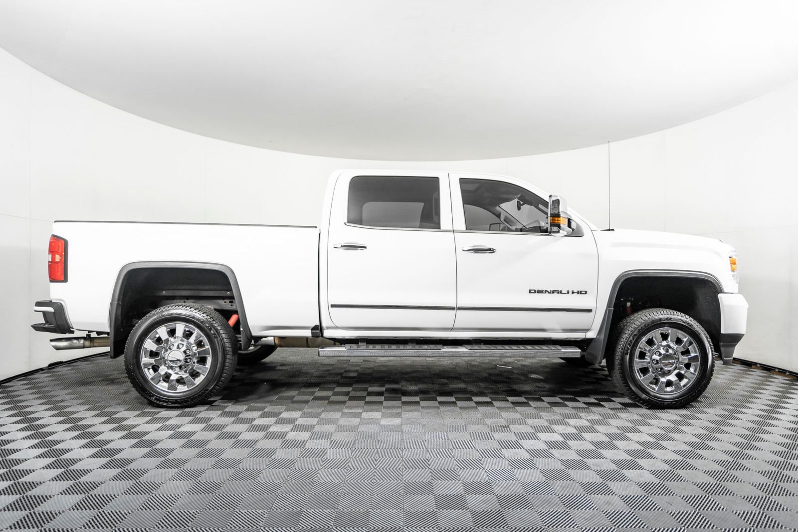

Hi everyone! I bought just a 17 Denali from a dealer who leveled her. I have been doing some research on leveling the front and raising the entire truck. I would like to get some bigger tires, not sure what the dealer did exactly,to level the front. Looks like they cranked her up at the torsion bars. The UCAs are stock and I don’t particularly like how the ball joint is at an angle. So that is the first thing that  needs to be addressed. I would like to install a diff drop kit to straighten the cv shafts. I found this kit attached below. This may be just what the Dr ordered seems to cover everything, as far as leveling.
https://suspensionmaxx.com/product/SMX-GM-HD-STAGE2
What do you guys think of this kit? Anyone use this kit?
$1349 USD just seems like crazy money to spend to achieve a 3" lift in the front properly. You could probably find a quality 4" lift kit for around the same price, although maybe I'm wrong. I tow a camper all the time with my truck so I left the rake to accommodate the weight of the camper. I'd seriously consider just lowering the rear 2" to get the leveled look, just my opinion
youre 100% right. add on the tax and shipping and now youre at $1500.
for a leveling kit LOL? pass.
