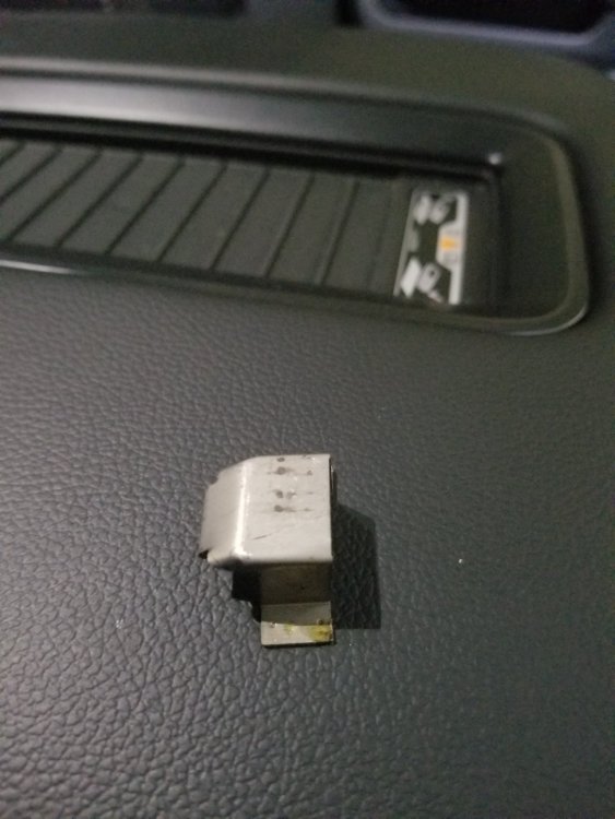

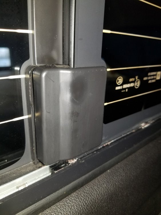

Have you had the work done?  Mine melted the plastic cover on the fingers that contact the outside window frame to give power to the center glass defrost circuit.  I tried soldering it back on and I don't know what solder they used but nothing I tried would stick.  It actually blew one set of the fingers off and took the plastic cover with it when it failed lol.  The fingers are all blued so they were not making good contact.  Truthfully I like to drive with the rear glass just cracked open  so that probably contributed to it although I never turn the defroster on... truck does that on it's own and I can't disable it for remote starts.  You can see the cover I mean in the bottom right hand corner of the middle glass.

I can grab one tonight haha.  I glued the melted back cover back on to hide the exposed contacts as this happened before the recall existed.  I will probably pop it back off again.

The piece that melted the cover and shot across the cab with the cover.  Yes I glued the cover back on and pulled the 30 amp defrost fuse.
Holy! I can't believe they actually had the potential of exploding.
