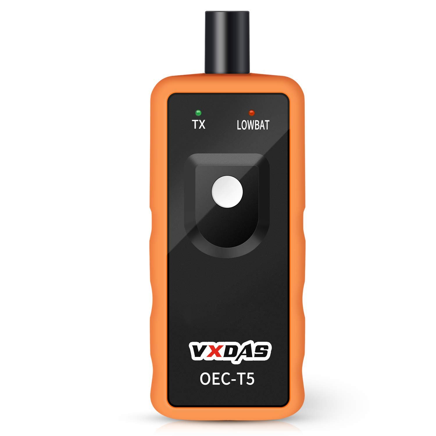

I'll add the procedure to re-learn below:
-Put the key in the "on" position
-Set the DIC to show the tire pressures, and hold the reset button (right side of steering wheel with the check-mark on it) until you hear a short beep-beep of the horn. Then look for the light.
-You'll see that the driver side front turn signal is on, so start with that tire.
-Put the tip of the antennae on the tire sidewall about an inch away from the rim where the valve stem is. Push the button and wait for the single horn beep.
-Look for the light. You'll notice that the passenger side front turn signal is on, so repeat the process with the front passenger tire. Then the passenger brake light...repeat. Then the driver brake light...repeat. Once you do the driver rear tire, you'll hear a beep-beep which says "you're done".
On 12/4/2019 at 5:58 AM, Lsgun1 said:
You need a special tool to do the procedure.
You technically don't need a special tool but it takes 5-20 mins to do a relearn manually. If you mess up then you have to start over.
You can stop by any Americas/Discount tire and they will do if for free.might be waiting for a few mins until they can help you.
