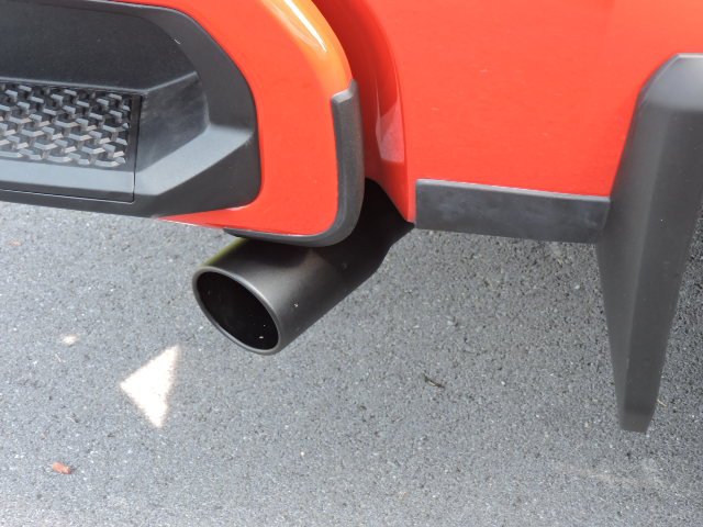

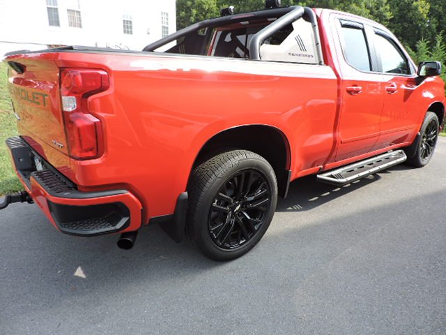

I put a tip on my '19 RST that I had purchased for my 2016 and it fits perfect. Those descriptions that say fits '19/'20 only is not correct.
Bully makes a stainless steel with flat black finish at around $16 ....that's $200 less than OEM black chrome.
https://www.autozone.com/exhaust/exhaust-tip/bully-truck-black-stainless-steel-exhaust-tip/935927_0
You can easily drill out the pop rivets and get rid of the Bully logo plate for a clean finish that matches the bumper step trim. At 3-3/4" the output width is 1/4" less than OEM.....and that's good because once mounted there is only about 1/2' clearance between the tip and the bumper.......every little bit of clearance helps to prevent a rattle hitting the bumper or placing a hot pipe too close to the plastic bumper trim on a hot Summer day. Really gives a nice throaty sound, especially on startup.
