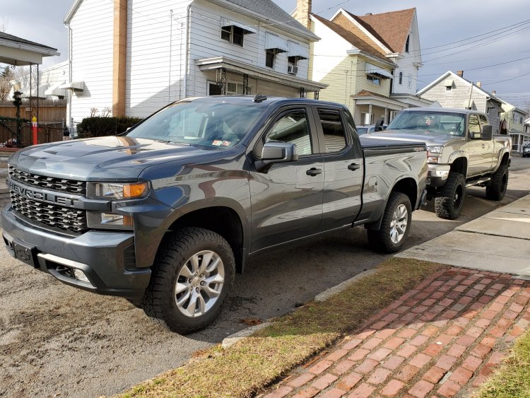

They are both just covers. I ended up not liking the bulk of the mirror covers so I removed them. The handle covers snap on and adhere with double-sided tape. They are available on eBay from seller "beyondbasik" for about $10. I was weary because of cheap they were but they are actually great quality. They cover the handle well and appear as close to factory as you will get without replacing the whole handle.

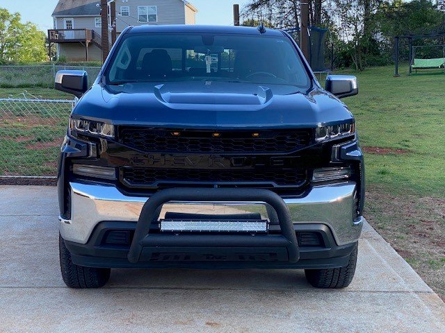

Got the "Raptor" style grill painted and installed.
Wow, that looks great!   That front end combines good elements from different sources: The neat LED headlights from an LT+ truck, the cool blackout style CHEVROLET grill from a Custom, and the three Raptor style LEDs up top.  Really nice! The chrome bumper and front bar are cool too.
Can you share some information about how you put this together?
  • Thanks 1
Thanks Jim,
Its my first truck a 19 LT.   I've always been a muscle car dude. (18 1LE Camaro,  16 Chevy SS)    But The truck was a great pick for Home Depot trips and what not.
I started with the TAC "bull bar" in a matte black.  Seeing how well it did with the NS blue helped me decide what to do. Every truck needs a light bar obviously so that was quickly added.   I always loved the Custom style grill, and love the aggressive look of the Raptor, so when I found a grill that incorporated both I had to have it.  Had the dealership paint it Gloss black, and installed it.
Also have Motofab 3" lift front and rear, Now just need some new shoes in a deep dark bronze and ill be set.

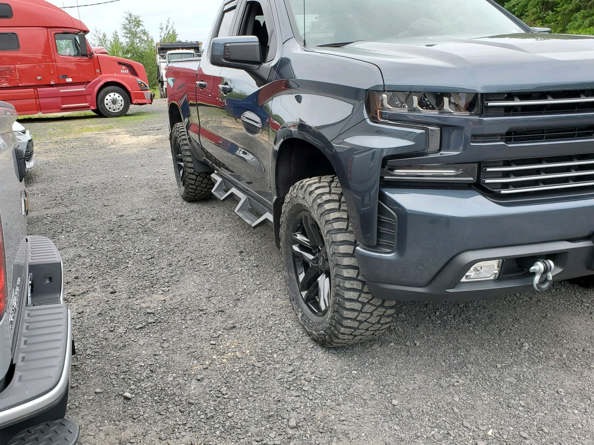

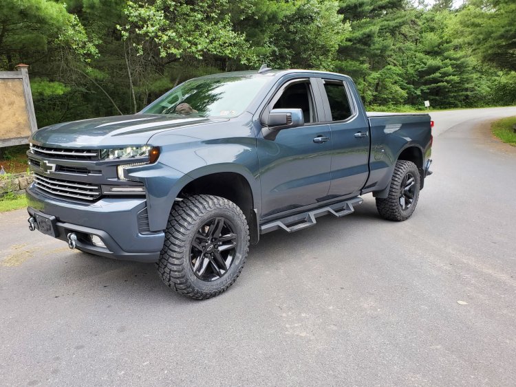

35 12.50 20 km3s load range e, pressures set at 35 psi. These ride nice and smooth and for now are quiet. They do rub on the mud flap at about 3/4 turn to full lock.
Also tinted the mirror lights and the amber headlight corner lights.

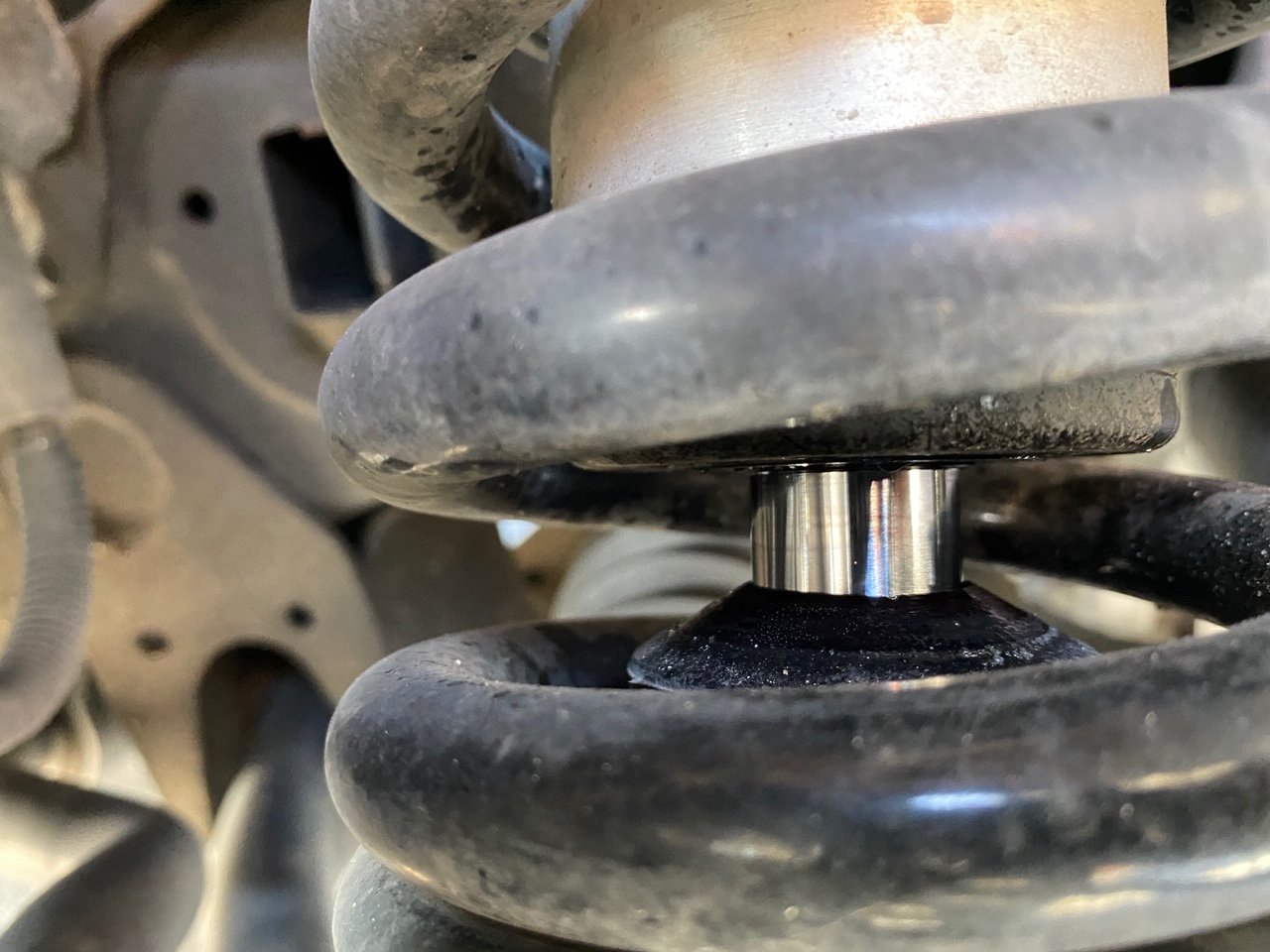

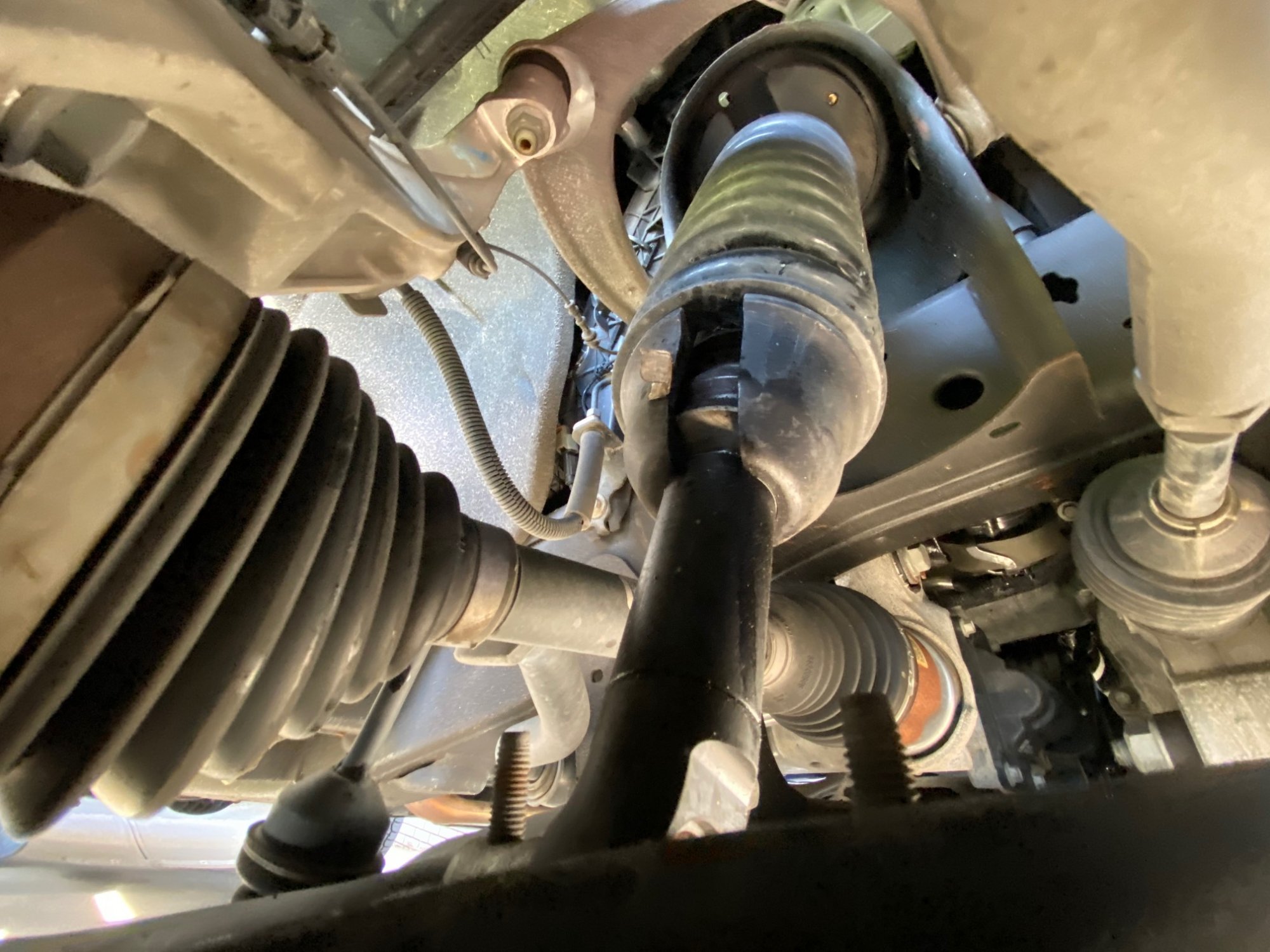

The readylift just didnt see like it was enough after seeing the 3-3.5 lifts. I purchased a stage 1 icon lift with the coilovers set at 3 inch and a rear 1.5 block with shocks. Plus I used a set of rough country control arms.20191214_121117.thumb.jpg.9e58abd32b354a0f9b308dc2eeed7f05.jpg20191215_113452.thumb.jpg.592e354d8fa48a889f6eba0af7d14338.jpg20191215_131919.thumb.jpg.ce284d290f3772f0c3cad20b0abccf84.jpg
How does it ride?  I’ve been considering the same setup.
In the pic it was really nice,, Its more firm than stock, but not harsh and handles real well too.  I will say tho with these set at any more than 2.5 they are real firm. The stage 1 are also not long travel. When I called Icon about what to do with it turned to 3.5 they told me to send em in and they will take a stop out of the inside.   So what I did was turn them to the top meaning at 1.5 and added a 1.5 level to the top of the coilover. Then with that to get to my 3.5 I just adjusted em a small amount. That way the preload is at a minimum.

Wondering how many miles you have on your stage 1 ICON coilovers thus far? After about 14,000 miles my passenger side coilover has started to leak fluid. I've started the warranty process with ICON...

Actually sent mine back last week, only 5k on them.  They ride too firm cranked up. So along with revalving them I had them redone to stage 3/4 with the reservoir and cdcv. They have real good customer service and will take care of you.
5k miles! Sounds like I'm lucky mine lasted this long (6 months, 14k miles). My issue is that it's my daily driver & I can't just leave it sitting on stands. So I'm thinking of having it rebuilt locally. Planning to have that conversation with ICON today to see if they'll honor it. I'm between NYC and Philly, so I figured there's got to be somebody who'd be willing to do the rebuild. Do you know anybody?
