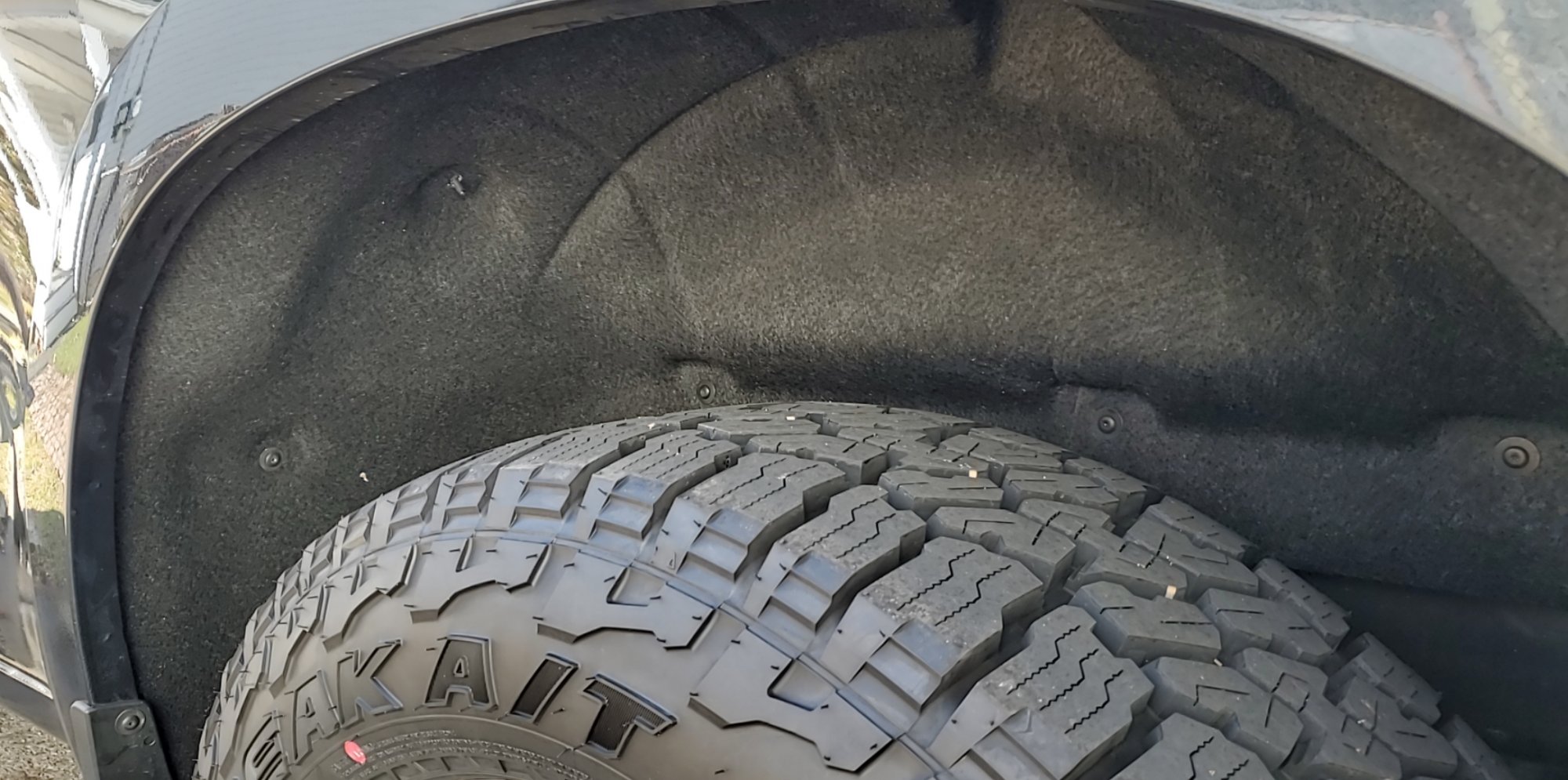

Here are a few post from doing mods to my 2019.  First I did silver tailgate letters and removed the emblems, they come right off with fishing line and a blow dryer. Gm rear fender liners fit really nice and are worth the cash. Plus a set of plugs to go in the top of the bed rail to cover up the holes. Lastly a coat or Adam's ceramic coating on the wheels and every painted surface.

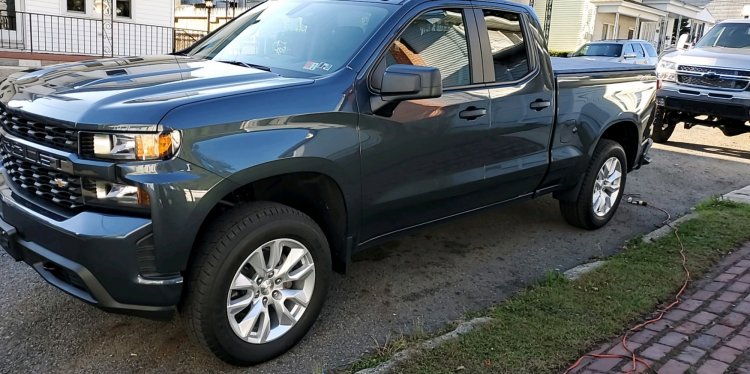

Readylift 2 inch level, 295 60 20 wildpeaks, painted mirror caps, stock led for lights, morimoto low beams and a tri fold toneau.20191107_161858.thumb.jpg.e4722ebd522003fcfc4309d98b2bdb94.jpg20191107_161846.thumb.jpg.d5396897b2a2b21d571b4820a3c33e5d.jpg20191226_192352.thumb.jpg.e7351502aef39606a6be3df353d7e01f.jpg

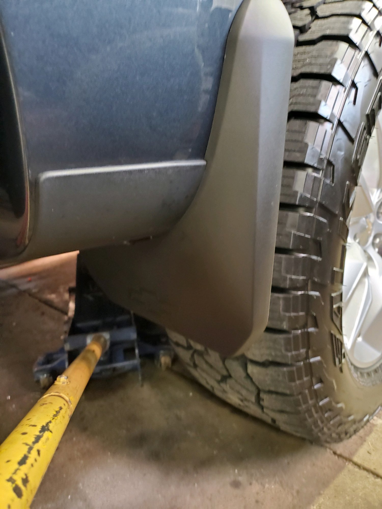

The gm auto dimming mirror went easy, the plug was glued to the roof. Few torx screws and the jobs done. Mirror was plug n play and works perfect.
The mud flaps I used gm part # 84649174, larger rear mud flaps. These fit perfect and cover pretty well.
