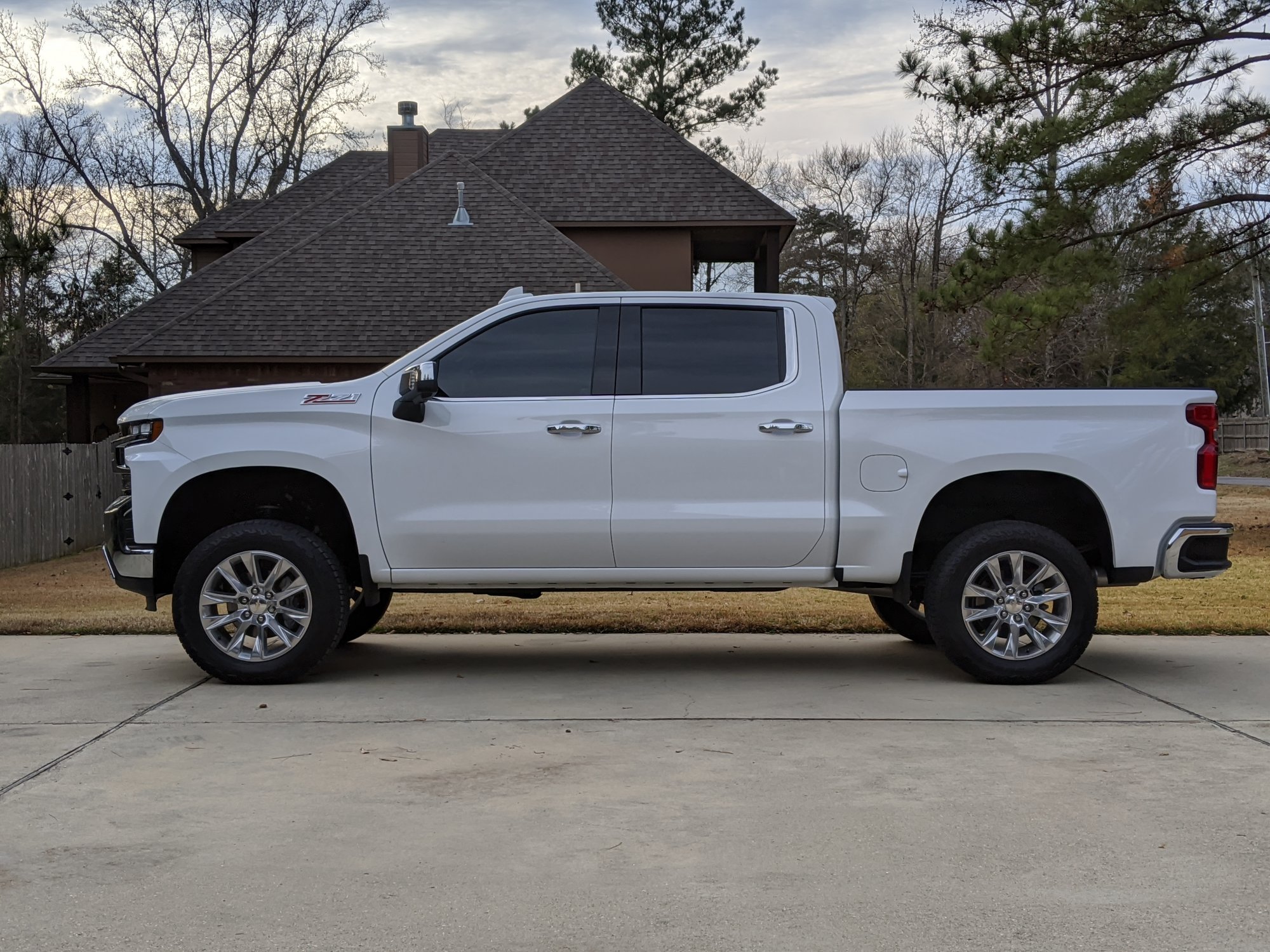

4" ReadyLift with stock wheels/tires.
I can't recommend it though....CV angles are too great resulting in noise and vibration.  Mine started immediately after install and is getting worse.  ReadyLift says they are within "safe tolerance" but I cannot ignore the noise and rumbling it's doing.  I'm taking it off this weekend and ReadyLift is giving me my money back.  I'm just putting a set of 2" level struts on it and calling it a day.
I think this is a more widespread problem than they think because most folks just chalk it up to tire noise.  I'm on stock Bridgestones so I hear and feel every little thing the truck is doing.

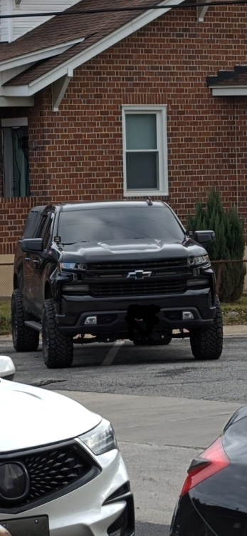

Hey I know im a few years late however I didn't find much when I searched for my build so I figured I would post
2021 Silverado Z71 RST
4in BDS coil over lift
OEM 18in wheels (came with the truck from dealership)
35x12.5x18 Nitto Ridge Grappler Tires
I ran 2in adapters to avoid tie rod interference
