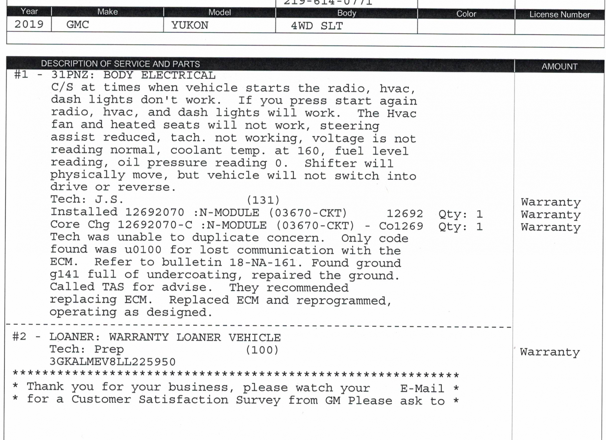

Got my Yukon back today after 17 days.  The ECM was replaced as previously noted, but one additional item that was found was that ground #141 was found to be full of undercoating.  I'm not exactly sure what that means or where that ground is but it was my understanding that the frames were waxed.  Regardless, I'm not sure why they are still mentioning TSB 18-NA-161 which is what they supposedly completed the first time in January.
Still mentioning that the only code found was U0100 for "loss of communication with the ECM."  It was from the advisement of GM TAS that the ECM be replaced, so that's what they did.
