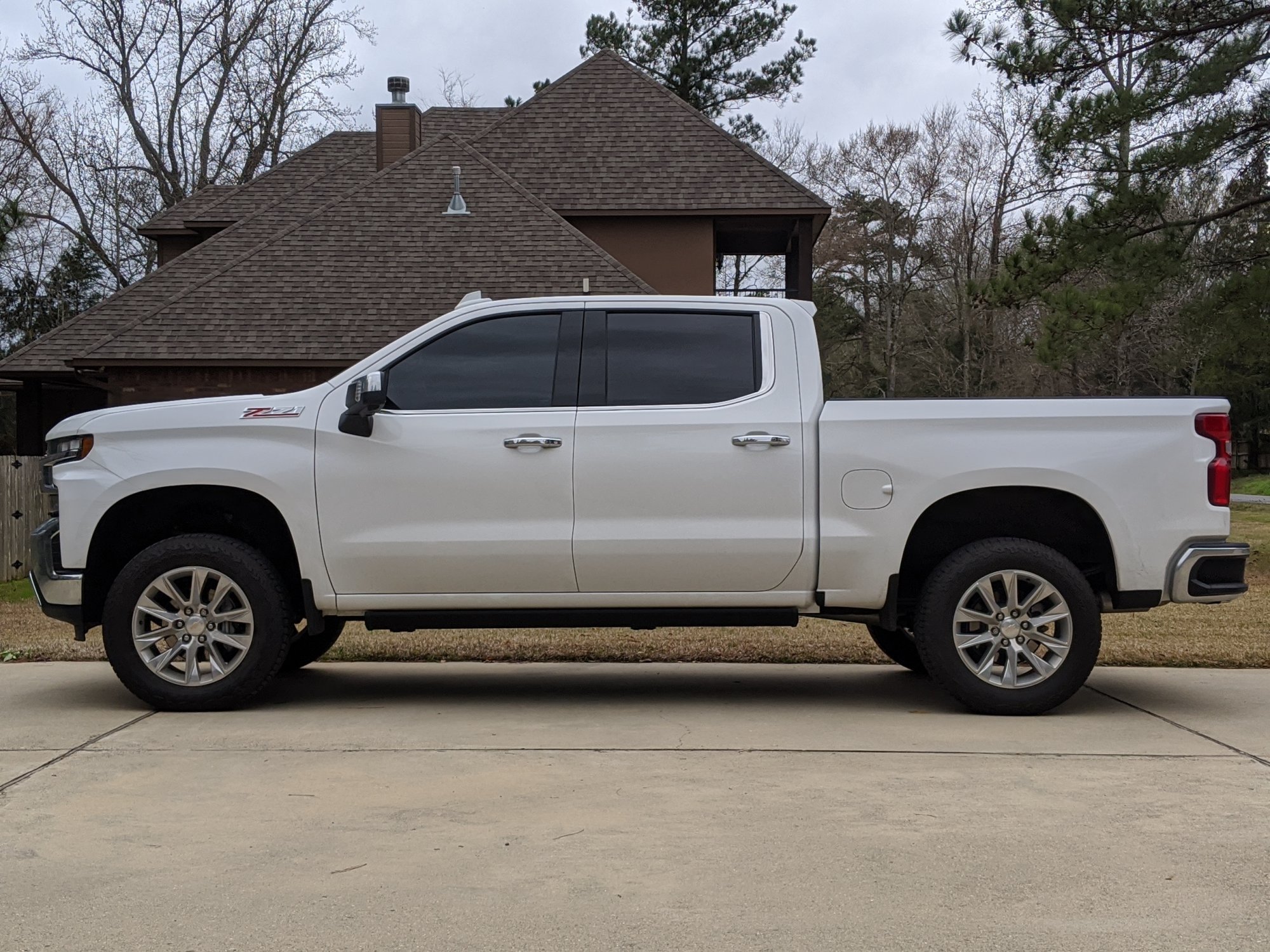

^^^^^you should be fine.....rear shocks are made to work within a range of cpl of inches
for some reason the TB kit seems to have more rake than standard models, maybe its not a full 2" in front
a few have added 1.5 leveling spacer with this kit and still has tiny bit of rake (which I like actually)….
just seeing the TB at dealers they look more raked than mine but idk if its true or not...
a 1 in block would probably be the call if you want it as level as possible, or add 1.5 RC or motofab spacer to front

can anyone confirm if this kit is actually a full 2in in front, or is it more like 1.5 or 1.75?.....they sure seem to have a lot of rake and seems 1.75 levels a TB?.....
nevermind I found one
front is about 1.75 and rear is 2, that's reason for excessive rake it seems
