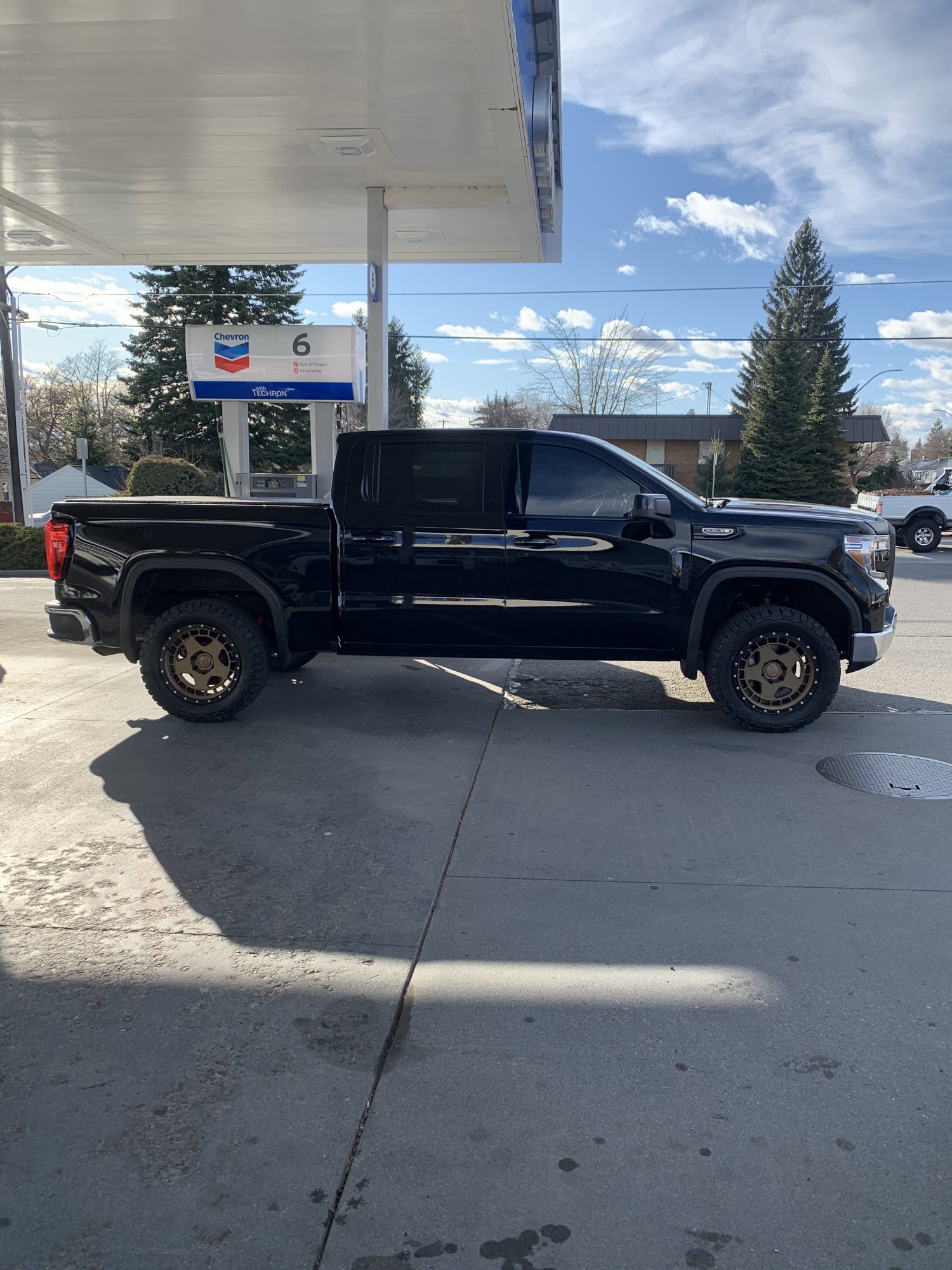

Touched a nerve I guess. Was simply trying to illustrate the massive transformation it has been through, but the only comments seem to be on how ugly it was before. I’m well aware lol. Sorry for my curt reply.
9 hours ago, Kintnerboyredoubt said:
Anyone else want to jump on the bashing my truck bandwagon, feel free. Hit a pothole and cracked the inside of the rear wheel it was a cheap fix knowing I was getting a new set of wheels. Dealer had that one laying around. I didn’t even notice to be honest. I was simply trying to give an idea of the transformation that the truck has been through which I thought was quite good but no one can focus on what it looks like now.

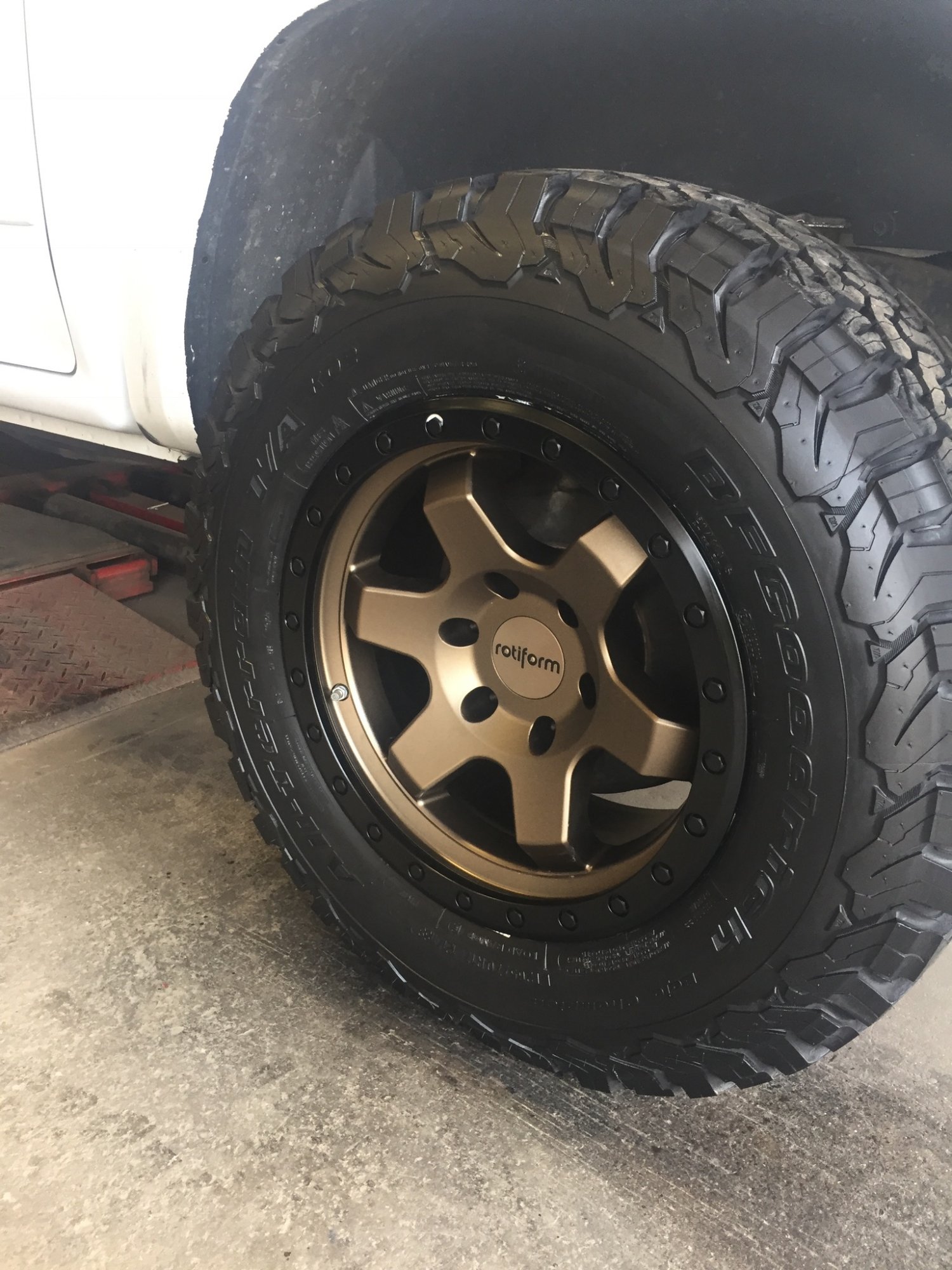

Thanks for this post dude. I did the Readylift 2" under strut level and put some 285/75R17s on some Rotiforms and was having the reverse rub with very minor turning. Stuff like this keeps forums relevant. Nice wheels too, not many people do anything creative outside of all the cliche hostile and fuel stuff.
@cseaman glad you found it helpful, full disclosure I someone else wrote that post up but I had to do some digging to find it. Did you go with the 6OR rotiform wheels? I had those on my last truck and almost bought them again. Post some pictures when you get a chance!
Yessir. I have two other Audis competing for my mod budget so I couldn't justify anything forged on the truck, but it's nice knowing I'll never see a twin in this thing.
