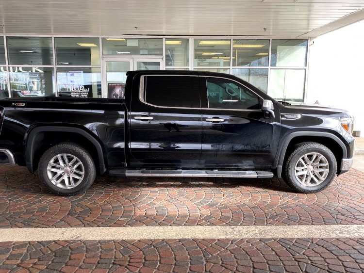

GM 2" lift installed
I have under 500 miles on it so far. I was afraid to tint the front and the window be cracked when they were replacing my headliner. It will be tinted this week tho.

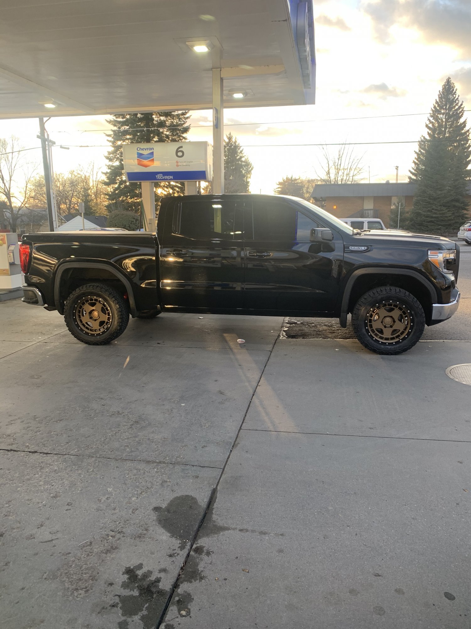

Got mine back, the leveling kit I had (spacers) wouldn’t work so I ordered a rough country level which is going to be installed on Friday (need more clearance) pretty happy with how it turned out, I didn’t take any before and after shots but changing the wheels and tires it wouldn’t of been very helpful anyhow... ran out of daylight today I’ll post some more tomorrow
12 hours ago, Kintnerboyredoubt said:
Got mine back, the leveling kit I had (spacers) wouldn’t work so I ordered a rough country level which is going to be installed on Friday (need more clearance) pretty happy with how it turned out, I didn’t take any before and after shots but changing the wheels and tires it wouldn’t of been very helpful anyhow... ran out of daylight today I’ll post some more tomorrow.
Were those the factory wheels and tires on your truck?  They look horrible!  What are your new wheel and tire specs?
Haha,  yes they were factory on an SLE Sierra. Truck was so ugly I almost didn’t buy it. New wheels are Fifteen52 Turbomac HD in bronze, 20x9 -12 wrapped in BFG Ko2  295x55x20.
Anyone else notice there’s a GMC wheel on the front but a Chevy wheel on the back??
Anyone else want to jump on the bashing my truck bandwagon, feel free. Hit a pothole and cracked the inside of the rear wheel it was a cheap fix knowing I was getting a new set of wheels. Dealer had that one laying around. I didn’t even notice to be honest. I was simply trying to give an idea of the transformation that the truck has been through which I thought was quite good but no one can focus on what it looks like now.
