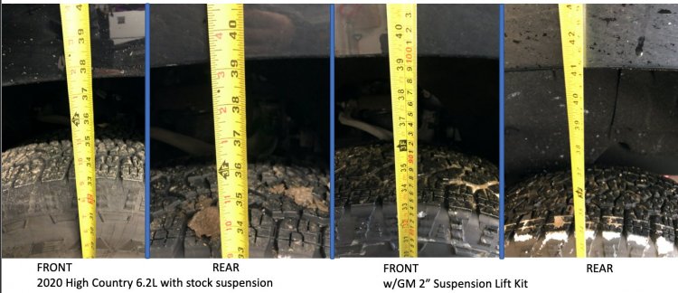

On 1/23/2020 at 5:19 PM, romclean1 said:
I saw someone ask about measurements... here is what I got on my HC - with the GM Trailboss 2" kit installed.  Stock 20" wheels and tires.  Truck looks sooooo much better with a little lift.  The ride is great, as good or better than before.  Can't wait to get my other wheels and ridge grapplers on it.
Looks great man! I need to get my HC done!
28 minutes ago, Kintnerboyredoubt said:
Looks great! Any noise from the cvs with this setup? About to pull the trigger on one myself, is the RC level upper or lower mount?
No noise or vibration.  The RC TrailBoss level is a VERY thin upper spacer and a preload spacer that goes under the spring.  Ride quality is same as stock.
you have aftermarket UCA, I think you do but wasn't sure, and did GM install RC kit when they did the TB lift?
Stock UCA....balljoint angle looks just like it did at stock height and there is close to 3/4" between UCA and tire.
I had the TB lift installed a couple weeks ago....didn't like the drastic rake, so I had them install the RC leveling kit last week.  I think it's perfect now.
