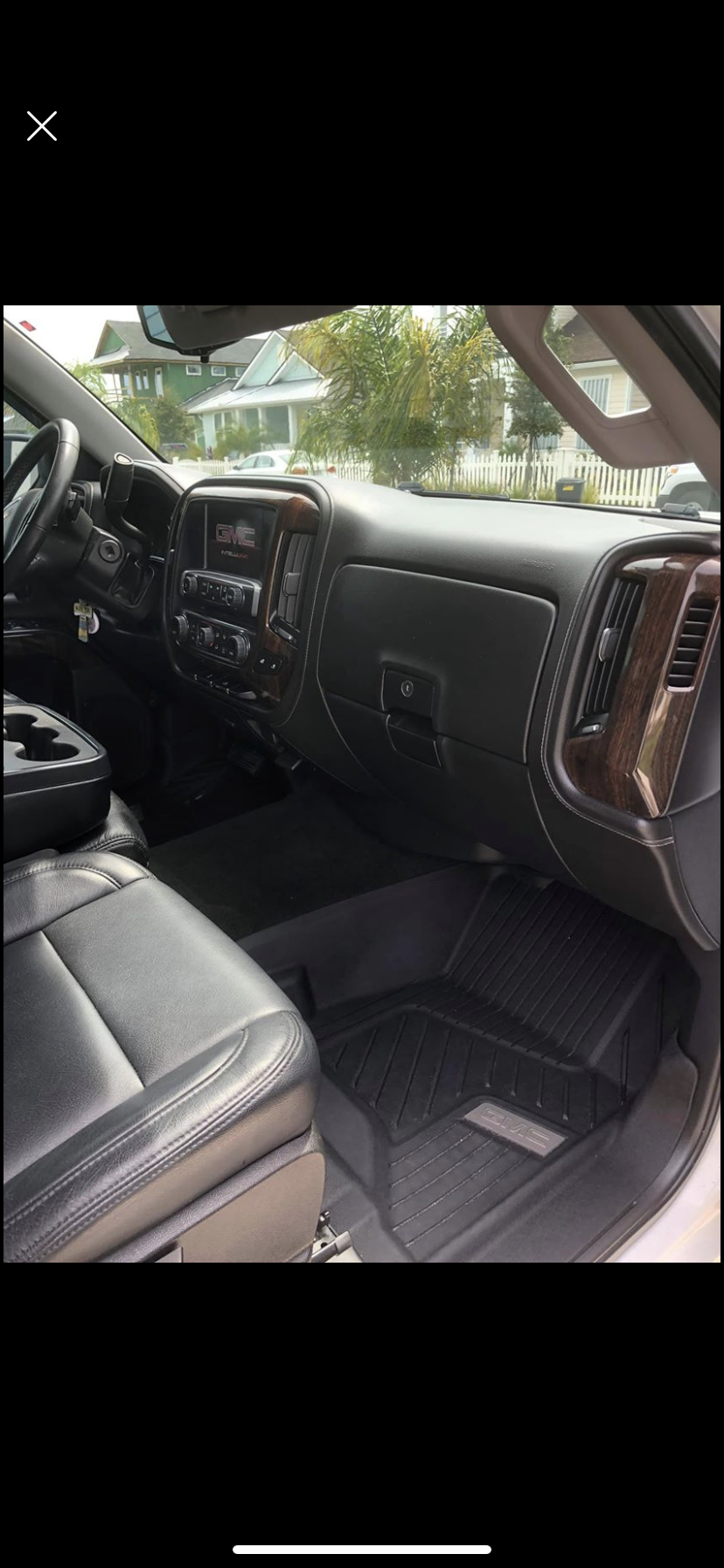

I am looking at buying a 2016 GMC Sierra SLE Texas Edition. The Owner had leather seats, navigation, and other things upgraded from the factory. But he says the seats dont have heated seats yet the two buttons are built in on the dash like every other truck I have seen. Is there a way to hook these up to make it work?

I believe i read through that thread briefly, and thats what prompted me posting here. Seems strange that bezel came from the factory but it does not have heated seats.
I think wams should now have the ability to program the bcm. Iirc they have a bcm program service now. Might be worth checking it out. I swapped heated seats in mine just to have power. I hope to get the heated portion working in the future.

Yea that’s strange it’s def a factory bezel but maybe off a diff model truck that had heated seats in it. Or it has them and they just don’t work. I would def try and get a little more history on it.
You can always look under the passenger seat for the black heat module. As stated maybe the elements or module is defective and the seller just said the truck didn't come with...

that is what i am hoping as i can fix myself and not that it is just a feature thats not possible to obtain. Going to look at the truck in person on friday anything you guys could think of to beware when looking at a used gmc youve seen since you have owned your trucks?

The leather seats are there from the factory and so are the switches?  I would think that they have to be heated.  Doesn't make sense why it would have been sold that way but not functional.

Yup enabling that is one of the standard features of the WAMS spec BCM.
