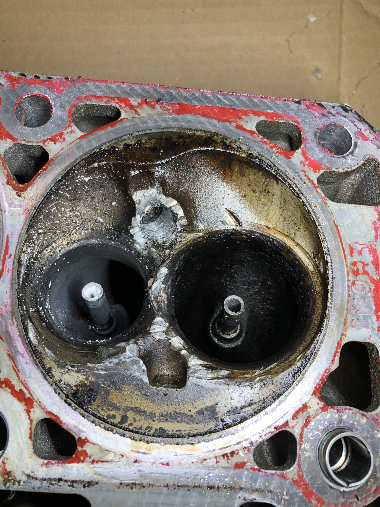

Well, she’s down for the count. BIGTIME.  On my way into the office yesterday she started a little miss, then bogged, tons of lights, then dead. All in a few seconds time, didn’t even have enough time to pull over in a good spot. Motor locked, wouldn’t turn. Got home, pulled the passenger head off to find this:
  • Replies 67
That wasn’t too bad. Kinda interesting with the rocker snapped like that. That’s a new one. But then I found this:
Annnnd then of course there was this. There’s also a hole very similar at the 12 o’clock position:
Rod is trashed and somehow bound up against the block.  The four pieces of the piston that are left move freely.
Anybody got a long block they need to get rid of? ?

Ran like a top till she blew. Per previous post, only a transmission shift tune. That’s it.  Broken exhaust spring and then bye bye engine.

Not to start an argue, but I don’t see DOD as a contributor to this issue.  This was sketchy springs, plain as day.
Yup...Sucks 1qty spring!  Sorry man.............
