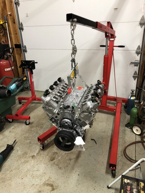

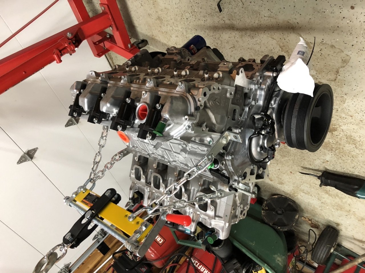

The new long block is dang complete.  Even has spark plugs and an oil filter!
