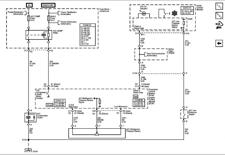

Ok ,, I read your reply...Think about this-- Truck has not had AC run for 2 days...if I start the truck when it is cold with AC turned off the compressor will not run AC.. and AC gauge set says high and low side resting at 70#...the cooling fans will still run on high after about 10 seconds of starting the truck... if I unplug the 3 pin pressure switch above the compressor the fans will turn off. if I plug the 3 pin connector into the old switch (the one I replaced) The fans will start to run even when the engine is cold,,, the temp gauge says cold,,,the AC switch is off,,, the compressor is not running,,,my thinking is the problem must have something to do with that pressure switch, the wiring to it, or the ecm.   Now the switch and the ecm have both been replaced with no cure no change, So i'm leaning toward wiring harness,, But I don't have access to a wiring diagram, and sometimes a person tries to diagnose a problem and thinks he has it narrowed down and so he keeps looking the wrong area,, sorta like when you look for your lost keys or glasses and after a long time you break down and ask for your wife's help and she finds them in plain sight in a place you could swear you looked straight at.  I'm lost on this one, maybe I;m missing something simple, you know,,, like maybe i'm making an assumption subconsciously.  Possibly someone else has seen this before ,or maybe if someone reads carefully everything I wrote they will pick up a mistake I made.   A wiring diagram MAY help.  I have worked on this so long that i'm starting to doubt everything I THINK I know.   Frustrated as hell. Dennis
Sorry but the short reply is no. That wiring diagram appears on my computer just slightly larger than a postage stamp.   When I print to paper as large as I can it is 5" across and blurry.  These old eyes cant read any of the print.   I do want to thank you for replying so quickly and trying to help.  Dennis
you may be able to find a pdf for the wiring diagram for your truck on gmupfitter.com, or, failing that, a subscription to the full service manual at a site like alldatadiy.com.  It'll also have the diagnostic procedures to figure out where the problem is.  I highly recommend it, particularly if you work on the truck yourself.

He is the schematic for the system.
