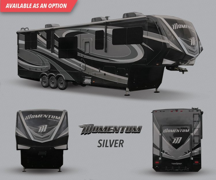

Thanks!! Very helpful, actually one I looked at online was the 381M, I’d need a 14-15’ garage so limits my options. Are you very happy with that the m-class build/features etc?
The grand design Momentums are one of the best THs imo. I looked at the 381m, but it will be way over on gcwr. 32100 if you just add the gvwrs together and the truck is rated for 29700. I don't know if it would happen, but you could get a ticket for that even if the trailer isn't loaded up to gvwr. I heard the state police will just add the gvwrs off the stickers together. The 351M gvwrs are at 16800 + 12100 for 18900 gcwr, but still under legally.
In any case, our limitation is pin weight. Fresh tank is up front and adds 1300ish lbs full. Since it's up front, it almost all goes to pin weight and would be about 4k! I don't plan on dry camping so not a big deal for me. I know rear toys help lvl it out, but not 1 for 1 and we only have 300ish lbs to spare. Keep in mind, you need a hitch or get a reese goosebox like me. The goosebox is heavier though by 115 lbs than the stock rota flex pinbox. All that and the trailer battery tale away from pin weight. Gd tells me the uvwr in their trailers include the stock rota flex pin box and propane filled. I'll cat scale mine in a few weeks.

Thanks so much! Very helpful especially since you have basically same truck and trailer I’m looking at. I just noticed the 351M and 381M are basically identical just different length garages.
Side by side alone is 11’ in length so would just squeeeze into yours. The 349M has a 13’ garage but slightly different layout. I’ll need to find a local dealer to see them in person I guess.

The garage area for the toys is always at the very back of the trailer, the last 10-15' depending on models. I attached a general photo I grabbed for reference but you can see that all of that weight from toys in the garage is pretty much behind the rear trailer axles reducing pin weight while loaded. However, I don't know how much of an effect it has but clearly it would have some effect due to it's location.
