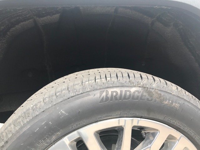

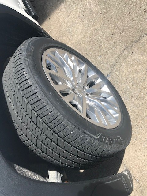

IMG_9430.jpg.5efa699a3dce24cbcb83b4ed2b5b0600.jpgIMG_9431.jpg.50cae200a6b371e647f5ed0cf833591a.jpgIMG_9434.jpg.64973041ffc4d8bef23785a829669715.jpg
Mines been at the dealer since tuesday. Gm told them to read force balance again and the numbers were all in spec. they drove it and it still did it. Gm then had them move the tires to different wheels to try and offset the vibration. Numbers still in spec after road force balancing again and the numbers got even better. Asked me to come in for a test drive and the vibration is worse at 67-70. Waiting for them to suggest the next fix. Since the vibration intensity is changing I assume they will suggest replacing tires.
