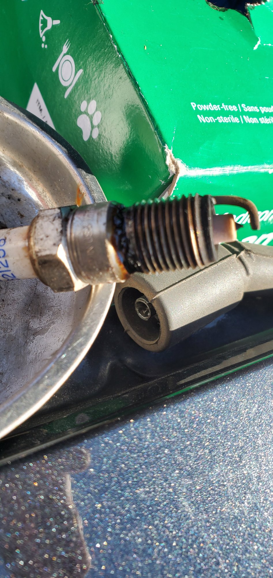

Ok I pulled the first plug on the driver side and it has very little oil just past the nut. I'm gonna pull the rest and see where I'm at
3 hours ago, swathdiver said:
Well, the new camshaft grind may not be compatible with the current tune, whatever that might be.  You have a lot of unkowns under the hood and the tuner can help sort them out.  Might not be the tune at all, could be a bad MAP sensor or MAF sensor or throttle body or a vacuum leak...
Ok I pulled the first plug on the driver side and it has very little oil just past the nut. I'm gonna pull the rest and see where I'm at. Or I'm hoping it's just a leak down from the valve cover.
