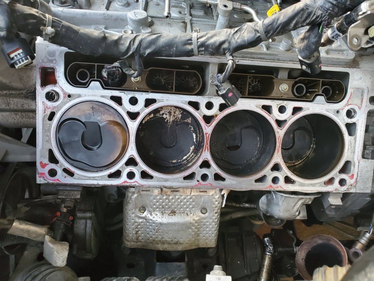

That is weird, doesn't look like the piston broke but like it was manufactured wrong. Everything in the head looked good and no other pistons look like that?
All other pistons looked good everything in the head is good. Going to replace # 1 piston and all rings.
