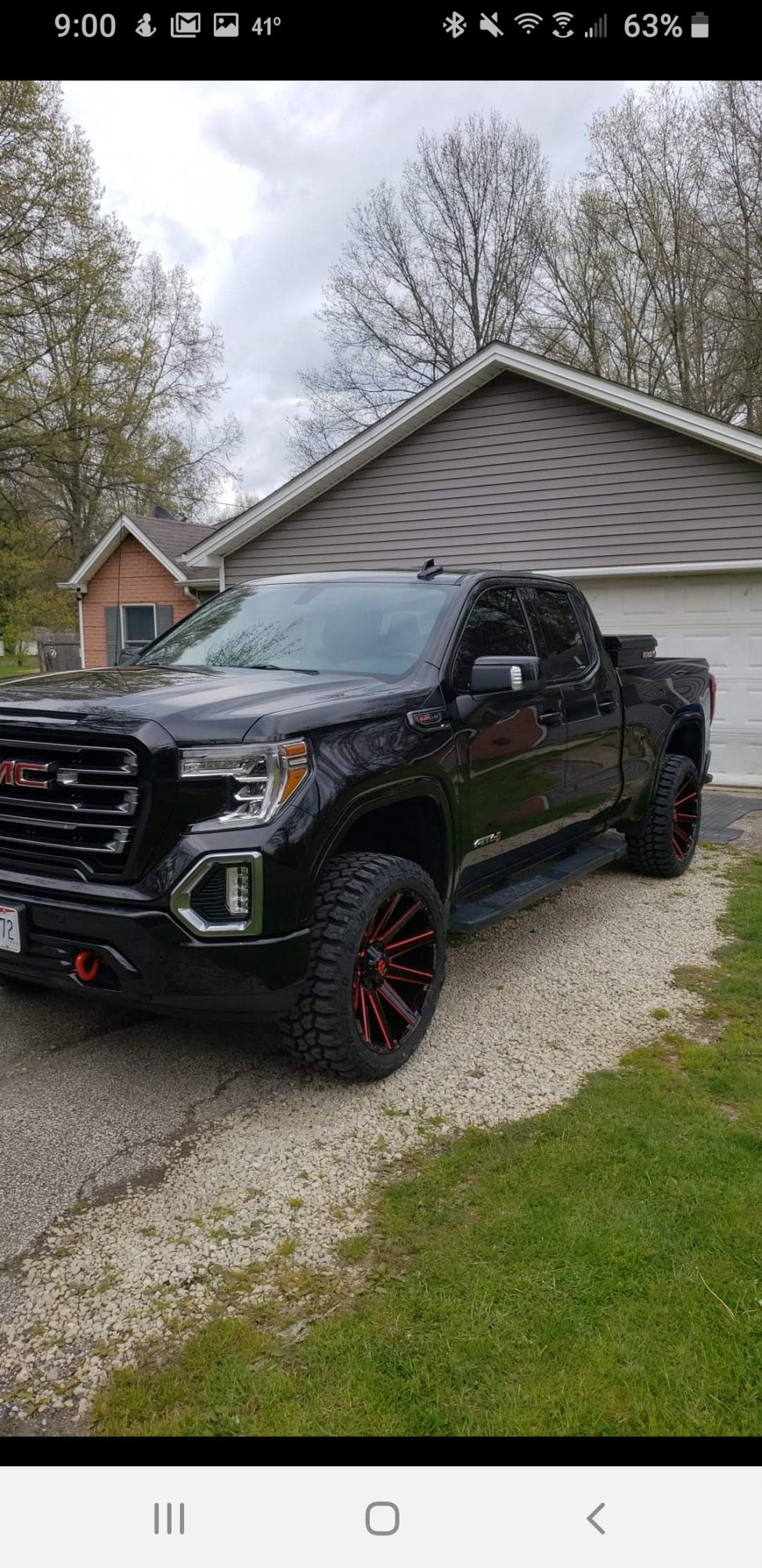

Just did a 2" level with 22x10 fuel wheels -18 offset. 33x12.5s only rubs slightly when backing up
Was that an AT4?
Yes sir
Ah okay, I was going to say...I wanted to run a more aggressive offset but without major trimming I couldn't. (RST w/ just a 2" readylift)

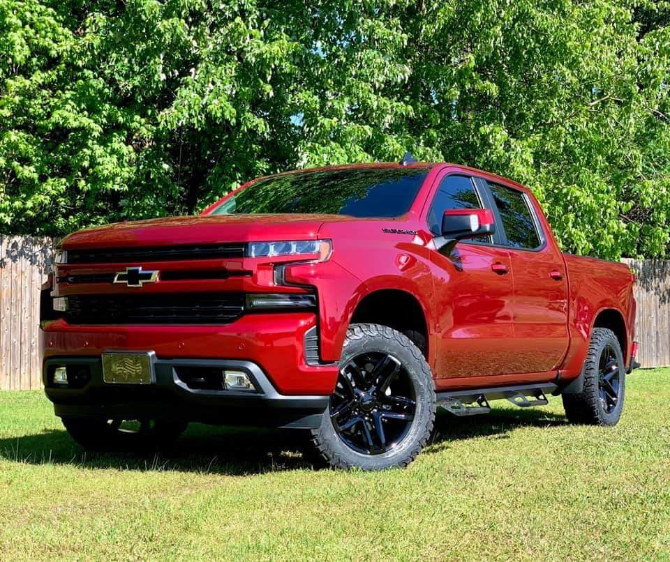

Not the greatest pictures. I will update better ones if people are interested. But this is a 20x9" +1 offset on a 33x12.5 tire. Slight rub at full lock. Took a quick look at the mud flap tonight but Didn't mess with the metal bracket yet. On a 2" level from readylift.

I have a 2 inch level with the similiar sized  20x9 +1 wheels. Im on stock sized 275/60/20 Duratracs and rubbed on full lock and random tight turns but only on the passenger side. I removed the mud flap bracket tonight and no more rub.

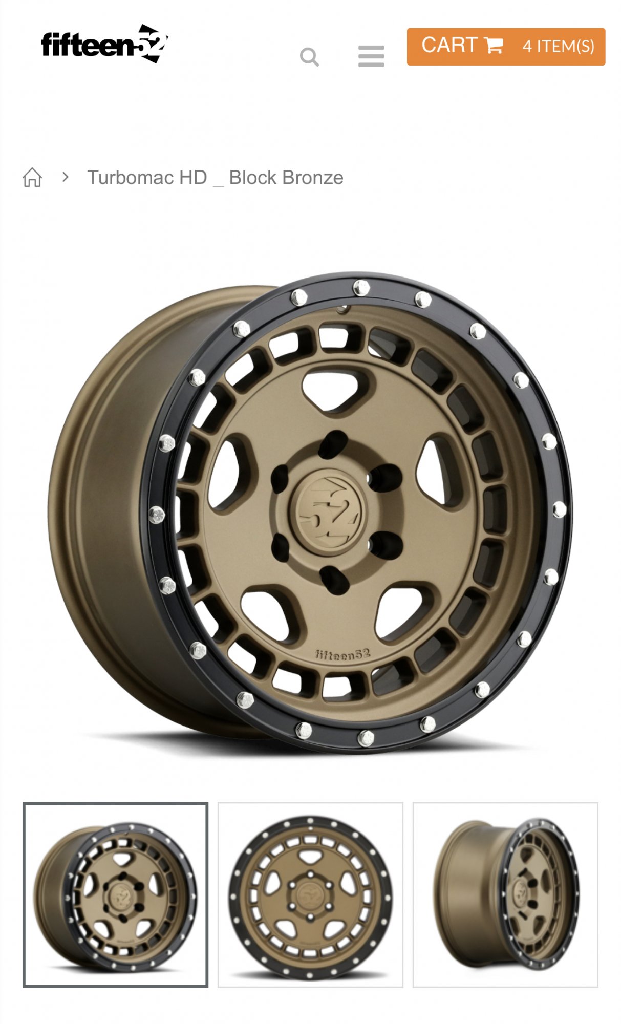

I did the RC level on my 19 at4 and just ordered 1552 turbo Mac HD’s in 20x9 -12 I’m gonna run 295/60/20 ridge grapplers I hope everything fits lol I don’t mind trimming the splash guard or mud flap.
