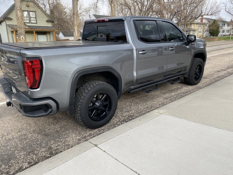

On 4/27/2020 at 8:47 PM, justin saleeby said:
i run fuel mavericks cant remember if it was 0 or 1 offset but with 285/60r20 its a good fit. toyo at3s
Any chance you could take a down the side shot to see how far they stick outside fender?  Much appreciated.
