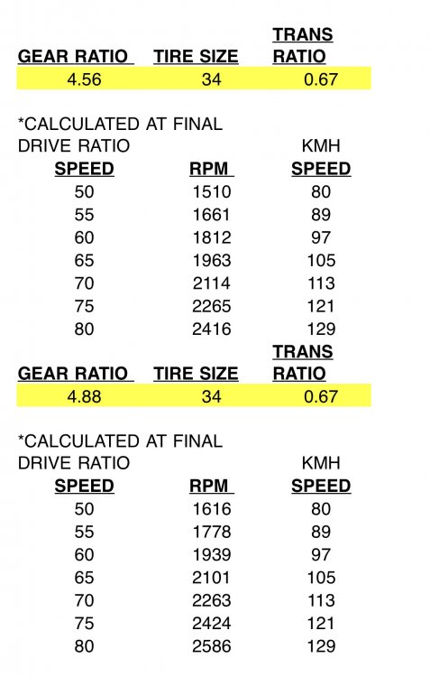

I switched from the stock 3.42’s to 4.10s in my 2018 5.3 on 33’s. Noticeable difference especially when towing. I wouldn’t go less then 4.56 with the 37’s
I would shoot an email to East Coast Gear Supply. Here is what they sent me to help figure out what gears to go with. This is for a 34 inch tire but he suggested 4.88 since I tow a lot.
