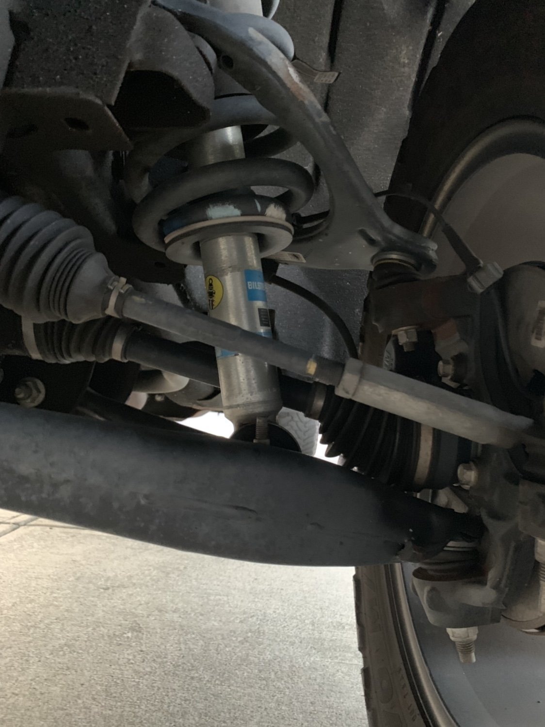

Here are some pics of My truck and the angles.
Yes, truck was aligned by the off-road shop that installed my 5100 and spacer and truck seems to ride straight as an arrow.
tires are 33x12.50r20 toyo MT, load range E, at 40 psi. They did rub the UCA at full lock when I got them put on, but I shortly after added 1.75” bora wheel spacers all around.
Truck looks sweet!
Your ball joint angles look a little stressed. You may have premature ballpoint failure with those angles. I’m sure others will chime in with their thoughts.
CVs are “ok” but a diff drop would help make the angles better.

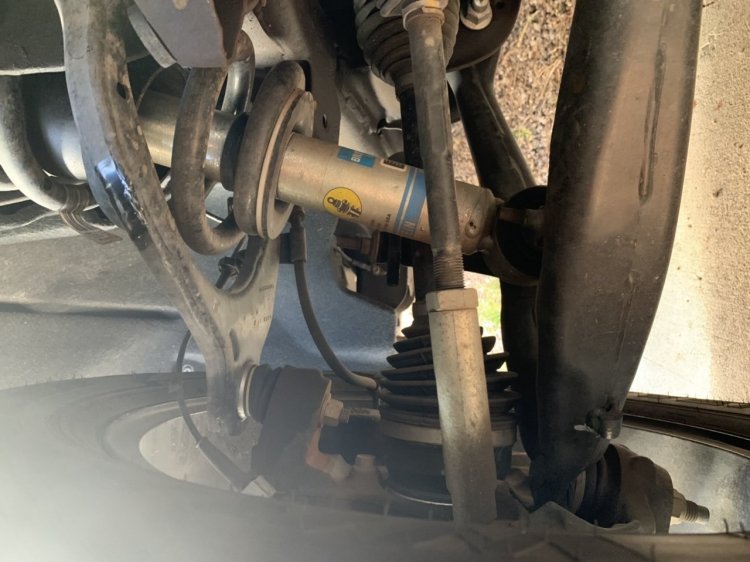

Here’s mine with bilstein on 3rd notch from bottom or 1 notch below top. I got 1.85” lift with just the 5100s. Maybe max tow package has stiffer front springs?

Thank you! Yeah Your angles look a little  better than mine lol, and that’s Wild you got 1.85” out of the 3rd notch. That’s what I’m on and it only got me around 1.25”.
When you say ball joints look stressed, I assume you’re referring to the UCAs? I guess my goal is to keep from premature wear, while getting slightly better ride. Aftermarket UCA should help with both of those things I assume?
