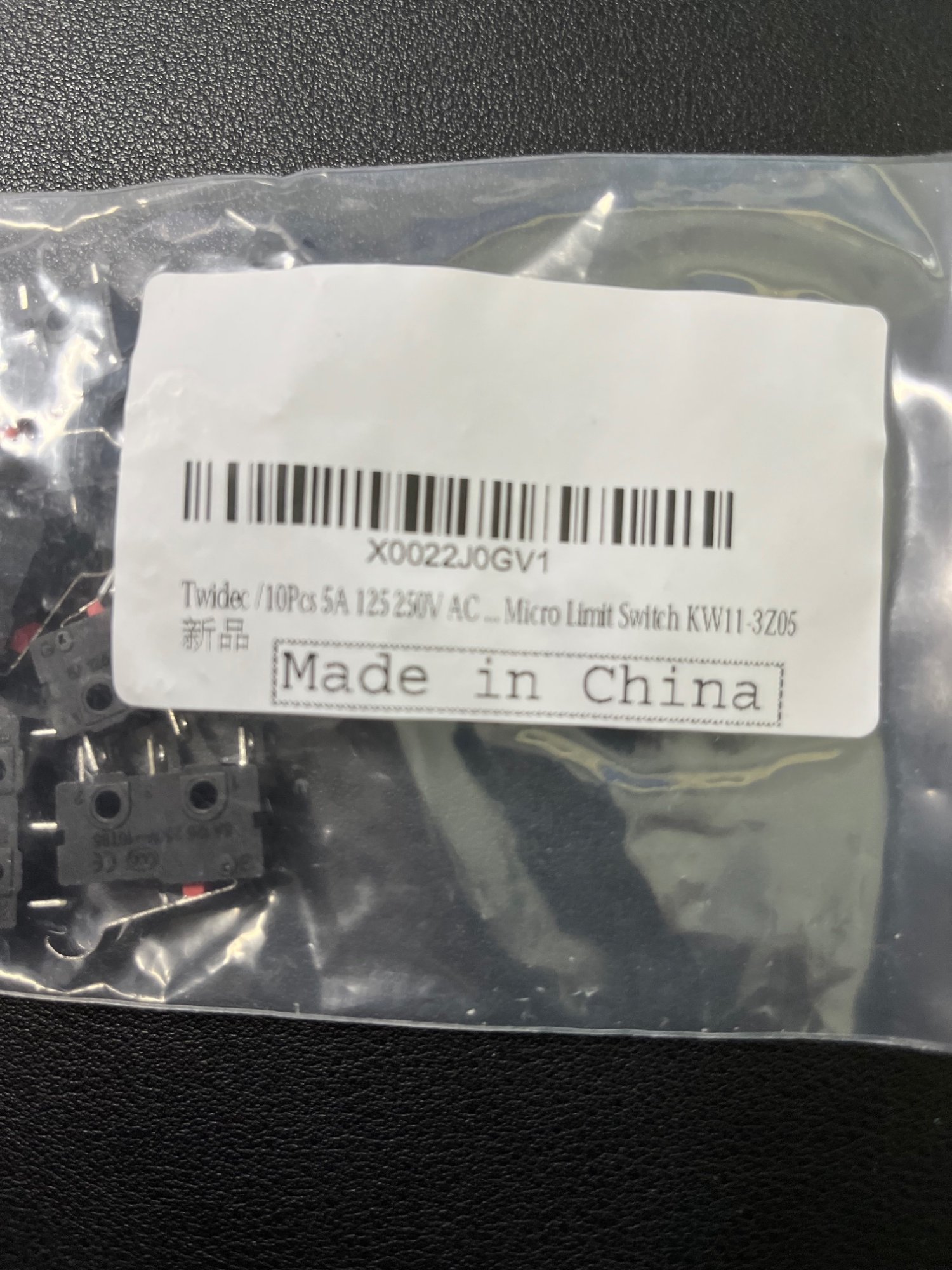

Any update from GM dealers on this issue? I'm taking my 2019 High Country in tomorrow for the third time. They second time they removed the transmission pan to see if a switch was loose. Nothing. I've shown them this thread, but GM won't give them the go ahead to replace the micro switch. They're waiting for the vehicle to give them a code. Meanwhile I've got 87,000 miles on it. Gonna bring this whole thread and the part number, everything.

2019 Silverado finally got a simple fix for shift to park hasn't done it in a week if you can get to the switch that was pictured above just put some electrical tape on the switch to keep it engaged. I took mine to the dealer and it was gonna be a $900 fix so this is much better on the wallet.

Just thought I'd share my quick and easy fix if you are not wanting to run to the dealer or wanting to order a new part. A lot of yall might have one laying around. I pulled off the switch from where it was mounted and used a small zip tie around the micro switch to keep it closed. Have not had an issues since. Bought my 19 TB back in May and this has been an issue since. Hope this helps anyone else!

Thanks!!! https://www.gm-trucks.com/forums/profile/255553-jeremiah-martin/ I have a few months looking to solve this problem yesterday it got real bad wouldn't stop at all from the shift to park message. So did what you mentioned removed the 3  7mm screws removed the bottom cover and jumped the micro switch with a small fuse, boom!!!! Fixed.  Looking for the replacement part but so far so good thanks again!!!
How do you jumped it?
Stick a paper clip or piece of wire across both sides of the switch.
On 3/4/2021 at 1:20 PM, Jeremiah Martin said:
Looked into it myself after finding this thread.  There is a micro switch under the column that is bad.  I jumped it and the truck shuts off normally. Trying to find the replacement part now.
How did you “jump” this? I have the same problem, except my message won’t go away no matter how many times I shift like previously stated. I have to remove the negative terminals from my batteries to make it stop, but it starts right back after I start and shut off
Stick a piece of wire under the two solder points.  Bend them toward the switch gently if it doesn't stay on its own.

Next time it happens, try this.  Look at the bottom of the steering column by the shifter. You will see an opening big enough to stick your finger.  Put your finger in there and you should hit the micro switch for the shifter.  Usually just touching it made the warning go away, and let the truck shut off.  It's a stupid fix, but short of buying the micro switch listed above, and putting in a new one yourself, it is an easy fix.
