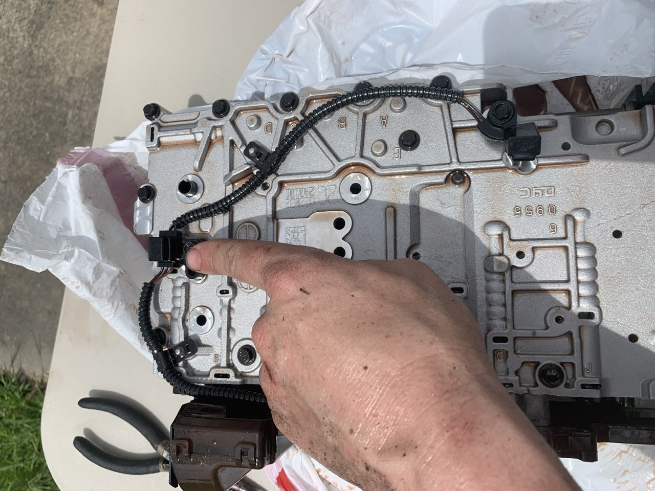

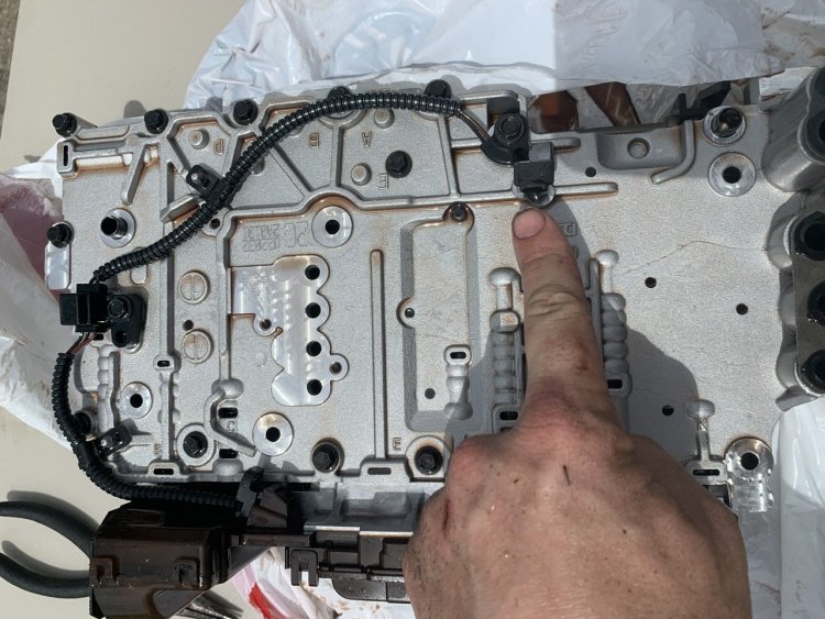

ok for anyone scratching their head on this one. The problem was buried very deep in the truck. Specifically between the transmission valvebody and it’s mating surface. There are 2 sensors on the top side of the valve body. Looks like my new valve body has bad sensors on it!!! Would have been nice to know that before spending $180 in transmission fluid. Lol
according to the wiring diagram, the VSS circuit passes through these on its way to the ECU. With them being faulty, it explains the erratic readings in GDS2, the no shift, and the no speedometer read out.
Interestingly enough no. It never coded the VSS, however it was showing unstable data coming from the VSS. Speeds ranging from single to triple digits. I’m guessing this aids the TCM and ECM in doing what the older chevys did with a speedo buffer. Since the VSS is a Hall effect, I’m guessing as long as something is coming from it, then the ECM assumes it’s good.
